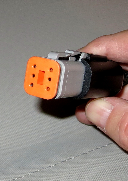

    Ok sorry for the dumb question to kick things off but here goes. I have just for my first HD. A 2015 FXDWG with a set of V&H Side Shots, Big Sucker Kit and Super Tuner Pro. Got my hands on the cable for the tuner but my old eyes cant seem to locate the port to connect to the bike.
    May I impose by asking for sombody to post a picture of the connectors location. I believe it to be a 4 pin connector.

    If it the same as Dyna Fatbob its under the fuse/ecm/bcm cover left side of bike and i would have thought it would be a 6 pin

    Correct Brett, it's under the cover towards the back and is a 6 pin -

    Ahh so I did find it after all. Seems that the connector changed from a 4 pin to a 6 pin for the 2015 model. I dont suppose you are able to identify the correct pinout? I can see in the great picture that only 4 pins are used.

    Additional Info..
    The 6-pin connector is on:
    2011-up Softail (with Super Tuner)
    2014-up Sportster (with Super Tuner)
    2012-up Dyna (with Super Tuner)
    2014-up Touring (with Super Tuner)
    2014-up Trike (with Super Tuner)

    Well I have gathered the goods to get in done. All I need is info to complete my cable. Please help with the pinout if you can.
