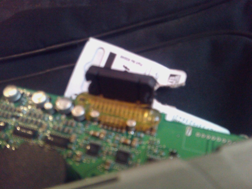

    mine decided some time ago  to just not make a sound... its alive and working. the screen is opperating normally..  just no output...
    choice 1  buy a new one   about $1200.... FARK OFF HD
    get one rebuilt  about $350 pluss freight  to and from the USA  so probably over $400.
    buy another unit that fits..  i think these start at about 400 in the USA  and there will be freight..
    SO  i pulled mine appart. found the output chip (ic) and finally decided what it is  because there appears to be no information i could find online
     I did find a ton of unhappy customers but hardly any usefull information..
    anyway  i finally confirmed my name for the device  and have found a hong kong supplier
    final outlay  under $35 for 10 output chips
    will take me about an hour to fit mine and see if thats the go.
    anyone else got a silent HK stereo in their tourer.. ][/URL]

    thanks  guys   the point was though  that if the chip replacement works  it will cost me $2.20  thats $ 2   and 20 cents  plus an hour of my time..  which is a lot less that $300.00
    if it works out  im happy to do the same for anyone else if they want,,  i have ordered 10 chips just in case..  if it doesnt fix the problem i will be a bit suprised  but only out of pocket $32.60 including freight.

    Hey Oneup, I'll send you a PM as mine stopped working a couple of months ago. I checked the codes and it said it was a speaker problem. Can't remember the code off the top of my head. I checked the speakers and they are all fine. Did a google search and it's a common problem in the states apparently. Would be great if this would fix it.
