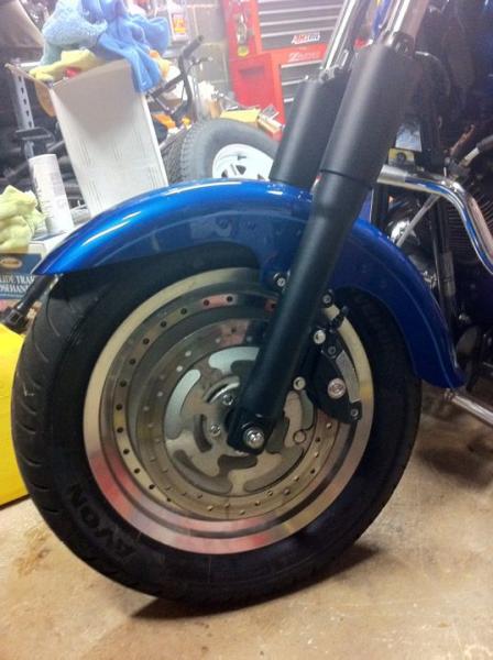

    Tat, part #41809-08a is the stock L/H touring disc and will fit with the Brembo caliper, but you may need to countersink the mounting bolt holes.
    I fitted the stock touring discs on my 2000 Dyna with the Brembo's , and the original disc mount holes are recessed (counter-bored), and the touring discs
    mounting holes are flat, so needed to be countersunk to clear the fork legs. The Fatty' may be different.
