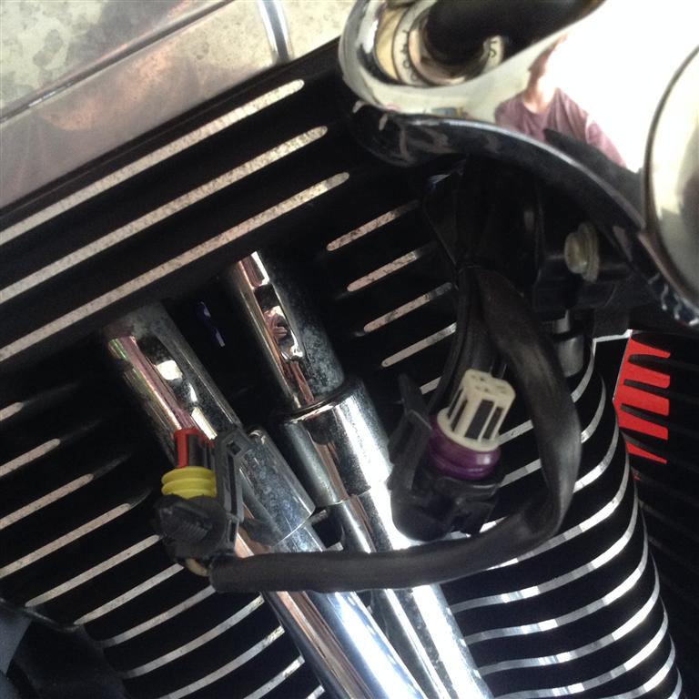

    Does anyone know what this lime and red connector is? It runs through the same loom as the TP sensor but I can't see anywhere for it to plug into. Ithe bike sometimes won't start when it's warmed up and 'm getting codes P0261 and P0263 and have checked the injector wiring with a wiggle test and traced it back but it seems fine so I'm not sure if this plug could have something to do with it.  The bike is an '09 FXDF.

  • Sparra
    Sparra
    It looks like the plug on my Wideglide that plugged onto the back of the standard air filter...When I replaced the filter I just left this unplugged tucked away behind the new airfilter with no adverse effects...
  • anonymousrob
    anonymousrob
    Ah Righto thanks that explains it.
