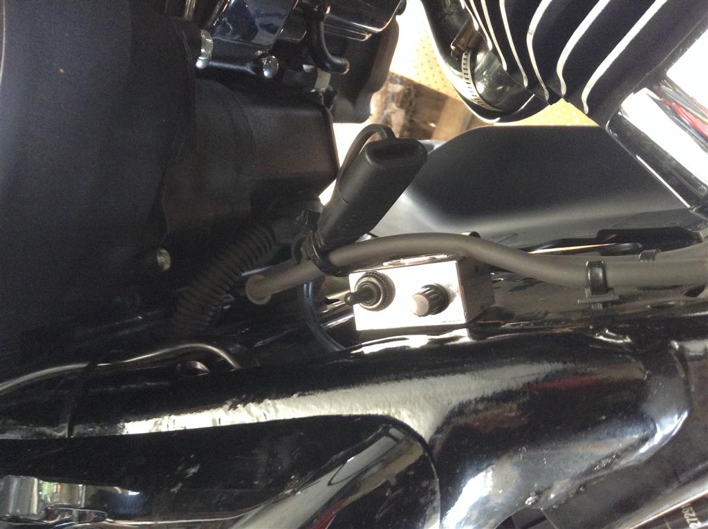

    Whilst attaching the mid frame heat deflectors on my 2012 ultra classic (bought second hand) I found a square one inch box attached the frame with a toggle switch and a rotary control. It looks like it could be a kill switch except for the rotary adjustment. The unit has the shield and bar logo.
    Any idea what it is please.
    Need a photo but could be either a heat control for a seat or grip warmers
  • david10
    david10
    Definitely not a kill switch, there is no adjustment on the hand grips to adjust temp, grips are hd. Could be to do with lighting maybe. Hmm.
  • david10
    david10
    That's the control for the Chick Magnet. The switch = on/off. The potentiometer controls the strength of good lookin chicks or full on fugly's for the rest of the boys...............
  • the_mongrel
    the_mongrel
    LOL!!
  • Wimbo
    Wimbo
    Thats a Garage Fabricated Switch box for chicks. Or maybe hazard light switch with intensity adjustment.
  • Tat2_u
    Tat2_u
    Ive seen this type of unit on another bike it was to control LED lights so the bike lite up like a xmas tree
    id say he has taken the stupid leds off the rotory control is for controlling how fast they changed colour
    a common thing on bike at Madi Grass
    was the bike bought in Sydney ????
  • david10
    david10
    Yes from Sys but out of melbourne I believe. I think you are on the right path everything is led including on the foot boards and under the tank. I am not game to turn them on because they are mauve, well pink really. Lucky it is a good bike low Klms and full of extras.
    I will spend sometime checking break lights etc they may flash etc.
    I also ride a GTR 1400 kawa so the best of both worlds. Just coming to grips with imperial and HD idiocincrices and mindset. As I say to everyone who asks it is a much better bike and ride than inexpected. Cannot keep the smile off my face on either bike.

    Decorative Lighting.
    ElEctrA GlO™ lIGht POD KIt*
    light up the night. these compact lED light Pods radiate
    a neon-like glow to accent almost any part of the motorcycle.
    Featuring a solid-state circuit board sealed against
    the weather, these self-adhesive lights can be placed under
    the tank, behind the air cleaner, or almost anywhere your
    imagination takes you. Electra glo™ lED lighting draws
    minimal amperage, allowing lights to be left on for hours
    when parked. light Pods connect directly to the motorcycle
    wiring harness, and the one-way wiring simplifies
    installation.
    the complete kit includes 6 light pods, basic wiring in a
    selection of lengths, adhesive wire ties, and a compact
    on/off switch with rheostat to control the lighting intensity.
    Available Expansion Kits provide plug-in installation
    of additional lighting.
    Fits all models. lights are intended for display use only.
    Some local regulations prohibit using colored lights during
    vehicle operation on public streets.
    67679-09 Amber. $174.95
    67680-09 Red. $174.95
    67695-09 Blue. $194.95
    67701-09 Purple.
