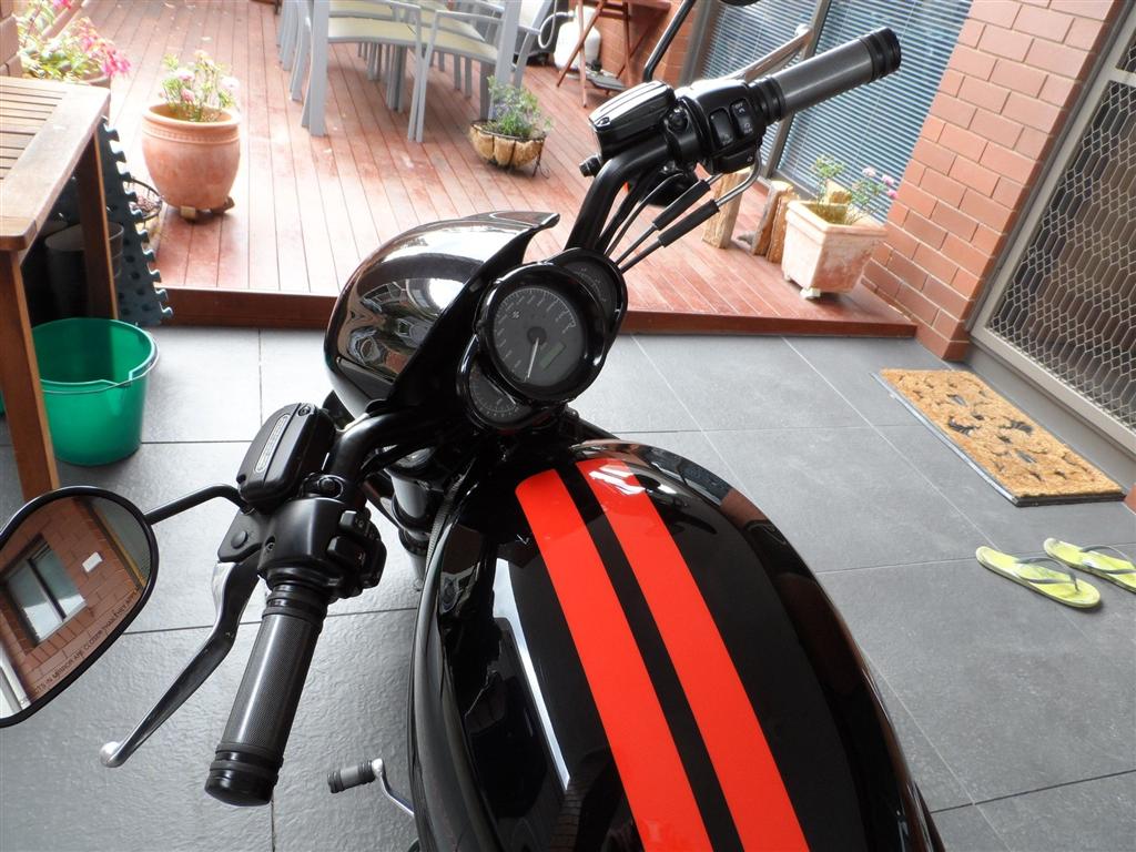

    Use Sportster Iron 883 bars. I put these on mine yesterday in just over 1 hour. Direct replacement NO brake lines needed but gives you nearly as good as Reduced Reach reach. Here's photos...

  • TassieTone
    TassieTone
    Hi Kym, no problem with bar installation at all. The knurl was perfect fit, about 1 mm exposed on each side of clamp. Everything fitted perfectly and they are easy-reach for me at least, I'm 5ft 6.5 inches. btw, I also fitted the easy-reach footpegs which are a big improvement.

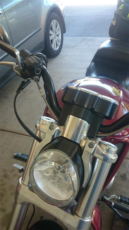

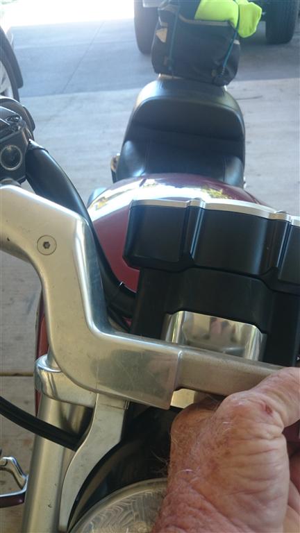

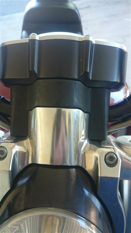

    Hi guys. I changed the bars on my 09muscle about 9 mths ago to night rod bars with risers. Lifted them up and back bout 4 inches. I have abs and NOTHING NEEDS REPLACING. All braided lines and cables will reach whilst going through the triple tree behind the light. I am about to re rout all my cables and lines outside the triple tree and headlight for an extra 2 inches. Buy a service manual and save yourself money and do it yourself. Hope this helps.
  • gcase2009
    gcase2009
    Gday guys. Here's a few pics of the changes I had to make. The standard bars on a muscle bolt straight to the triple tree no clamps. I am a short arse so to raise and pull back my bars 2 inches up and back I had to buy nightrod risers ( $120 ) from harley and nightrod bars. All are pictured. As you an see heaps of length on cables etc and I have since worked out if I fiddle with cables and brake lines I can get about another 3 inches using 8 inch wide glide bars ( $90 ) instead. It's easy so I hope this clears up some questions.
