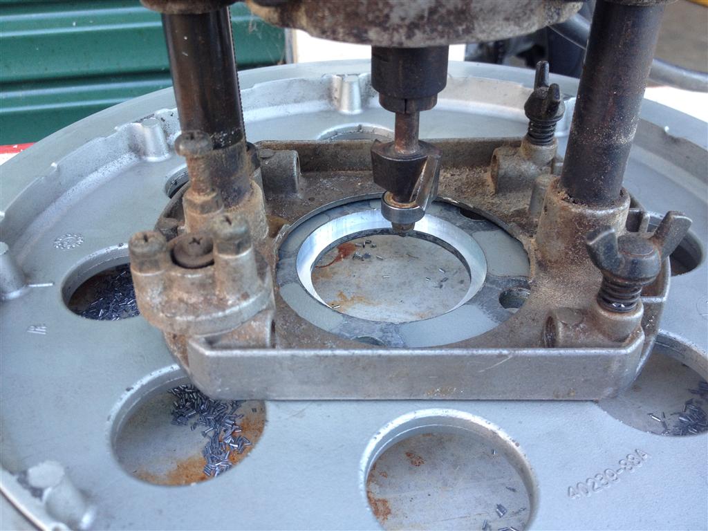

    The FLSTCI spoked back wheel fit, I had to re space both sides to centre the wheel, all I have to do is machine my pulley centre hole out to 56.5mm!

    machined the pulley to fit, wheel fits in nice and snug, need to space the pulley out a fraction to have the belt running true, all in all it turned out very good, the 150 tyre makes alot of difference,fills the back end out nicel;y
    cheers Corey

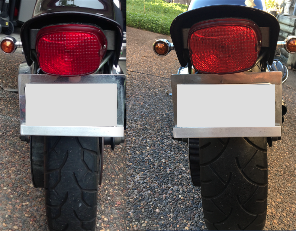

    Finally I got the rear wheel changed on my 87 FXST.  Went from the standard factory fitted 130 up to 150.  Fills out the rear fender nicely and make the ass end look tuff.
    Here's the before and after comparison
