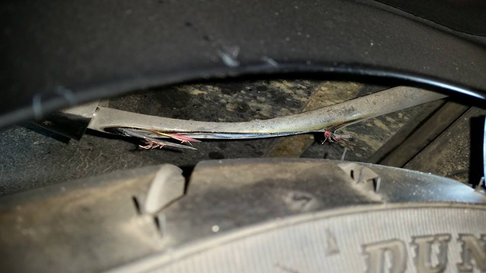

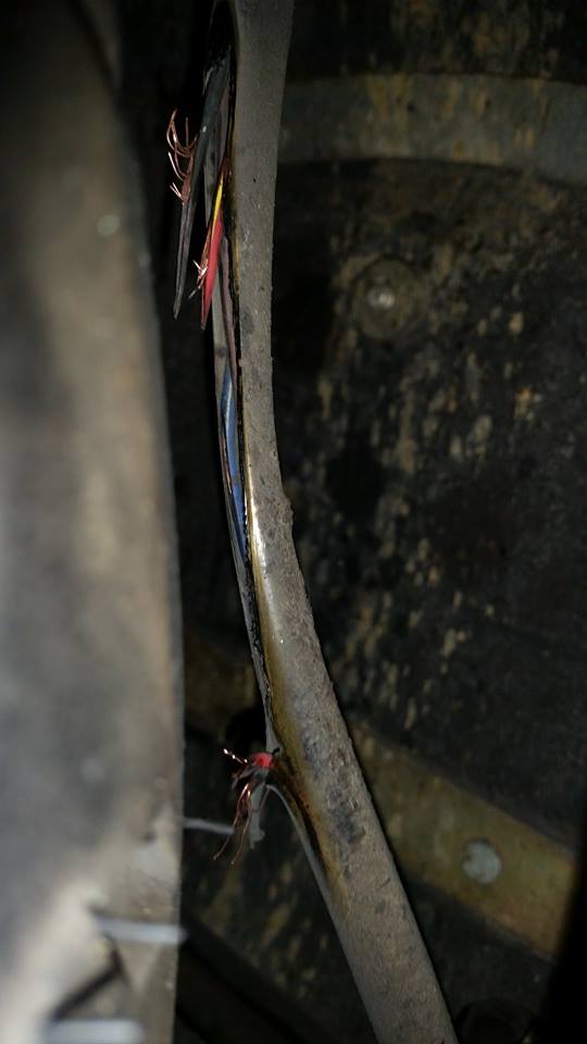

    hey, just looking for any ideas for the cause and possible solutions...?! was out riding yesterday, no problems, then i went to indicate to pull over and noticed that everytime i press either indicator. all 4 indicators and brake light flash, so does the little red key light on dash too.... bike starts and rides fine, thanks in advance
    its a 2010 fatboy lo w/v&h fuelpak.

    Check the rear wheel has'nt been rubbing on the wireing under the guard.

    cheers mate. found the problem. the wiring loom had seperated from the inside of fender and was laying on tyre, totally shredded the wires!
