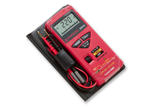

    I have a small wallet sized one similar to this that i keep in the bike on the larger rides. handy and small, does all I need it to do.
