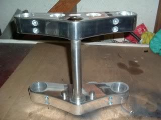

    The new trees
    A1cycles engineering are making wideglie conversion kit for 49mm forks complete with axle and all the spacers for the standard hub in 40mm aluiminium
    so I had a set off trees made to suit my project, they are made in standard rake and convential top, they do 3 and 6 degree rake and hidden top options for the conversion kits
    they arrived today and look a treat, big thick and highly polished

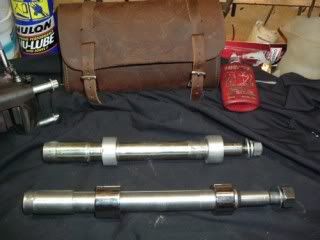

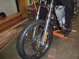

    And so the surgery begins
    this photo has the super glide axle and spacer at the top and the 07 softail axle (41545-07A) and chrome spacer kit(41597-07) below it.
    using the standard superglide fork legs and the wide glide trees these seem to be correct clearance
    so far the wheel is fitting ok, still have to put the brakes back on to make sure of the clearance

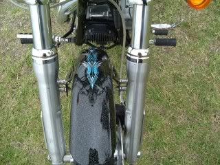

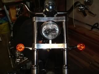

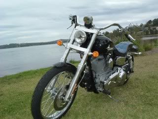

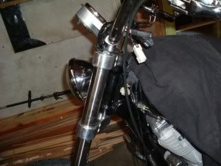

    This is the front veiw
    this is the side veiw

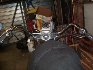

    this is the veiw from the hadlebars with westerns fitted
    still have to fit brakes and remove the plugs so I can put the wiring through the trees next weekend

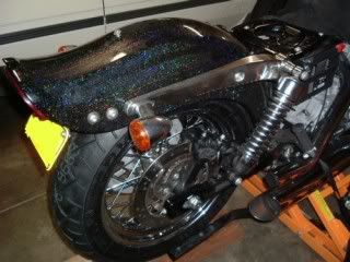

    and here is the spoked rear wheel fitted
    work in progress

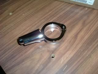

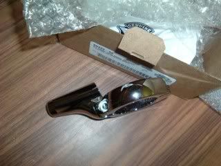

    New blinker relcoaction kit has arrived today
    Harley have come out with a new blinker relocation kit which is far better than the old one for 49mm forks (even if it is made in china)
    Part No 69433-08
    these are solid and heavy die cast and chromed.
    A far better effort than the 07's

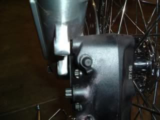

    Now for the bad news

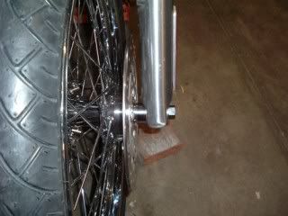

    When fitting the disc brake back on today I found that it dosen't line up, it is about 5mm out
    So now I have to either space the disc caliper or space the disc out 5mm
    Does anyone have any suggestion
    Has anyone tried to space a caliper out before

    Wideguy this is the front veiw of the new blinkers
    Grumpy you are a life saver, I was looking for stainless today to turn it up myself, I have just ordered a spacer from evil cycles on ebay
  • black29d
    black29d

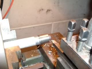

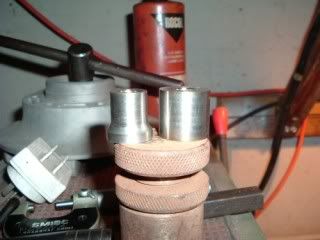

    Ok today I checked the wheels position and found that the wheel is off centre by about 5mm
    so I swap the spacers around and turned about 2.5 mm off the long one, then machined a packer for the other side, the wheel is now in the center positon
    and now the disc brakes lines up
    while I was on the lathe, I turned up some spacers for the front fender
    still have to polish them up

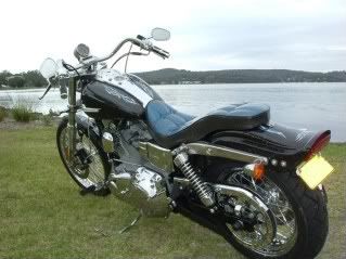

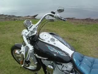

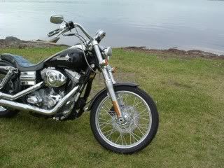

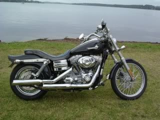

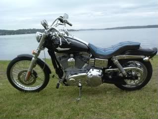

    Well it has taken longer than I like due to having to work the last couple of weekends, but I final got this project finished.
    I managed to take the bike for a shake down ride this weekend, and everything is fine, the bigger front wheel have improved the ground clearance a lot in roundabouts, which I am very happy with.
    The extra trail and fitting wide western bars make it feel a lot more stable, will have to give it a high speed run to see if it still shakes like the standard setup did.
    The narrower rear trye has solved the gaurd clearance problem
    The only thing I notice is if givin it a fist full into a corner and shut of quick, it wobbles a little.
    SO here are the final photos
