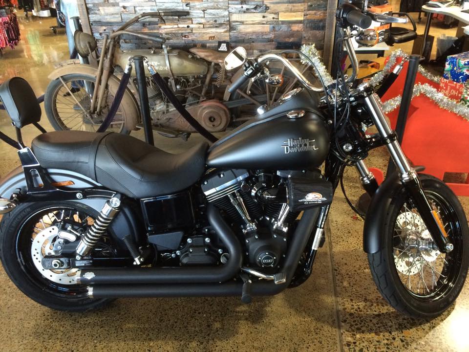

    ok so i have a harley davidson street bob
    stage 1 super tuner screaming eagle
    heavy breather air filter
    V and H straight shot pipes
    i love it! the neighbours not so much.
    i heard one neighbour one time swear and go off when i came home one time, i just ignored it
    but the other week my other neighbour (which i have a good relationship with, and is elderly) rang me up and told me its so loud it makes his house shake and he cant hear anything.
    i dont want to ruin things or cause trouble with my neighbours. and i love the pipes and dont want to change them, i dont have the money to get new ones anyway.
    is there anything i can do to quieten them? any temporary muffler or silencer i can keep on for a few blocks then take them off once im clear of my area?
    any advice on what i should do??

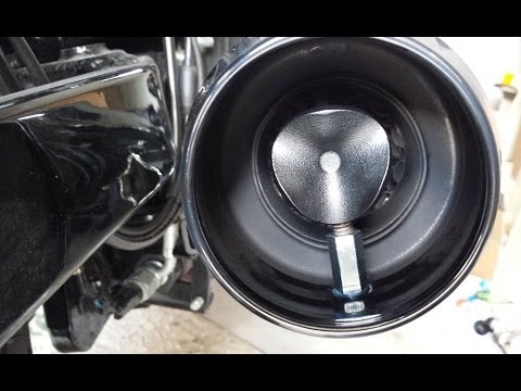

    Now i wouldnt go to this guys extreme, but at one point i was considering using the same idea but with 1/2 discs. Start with one to slow the gasses down alittle. Gives you the option of adding more if you wanted.
    http://youtu.be/_-tTyOtg5GY
    Also found this one but doesnt help much.
    http://youtu.be/lXLrEKXKKeI

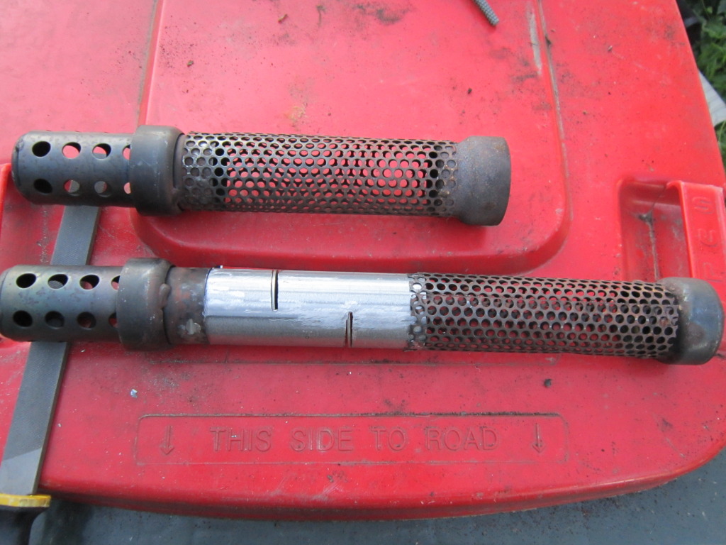

    this is what i did to mine.ok but still not legal
