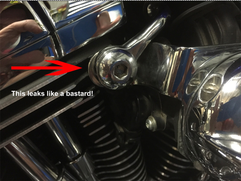

    Hey All,
    So I have a Kurry air kit on my Fat, and it comes with the adapters to take the oily air out of the breathers and NOT back into the air intake.  That's all well and dandy, but my problem is those fucking banjo bolts with the crush washers don't stop the oil from leaking out.
    Is there a better way?  I have replaced them twice, and still no joy.
    The fuckers shit me as the oil ends up splashed onto my pipes and oil tank etc.  It's fucked!

    Its this bit here that leaks man - on both sides of the breather.  Can't seem to stop it.
  • Ando
    Ando
    They look like SS washers???? Try copper washers or fibre washers

    They are actually these thin shim like crush washers, but they don't work.

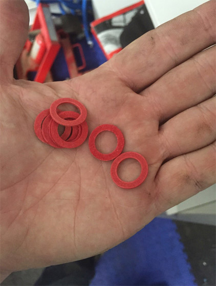

    Use a red fibre washer and even some flange sealant on them

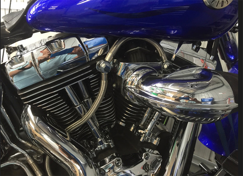

    So my new breather kit turned up today and is now installed.  To try and stop the leaks, I have installed using a combination of coppter washers and red nylon washers.  Let's see if that works.  It runs down under the bike to a nice little filter.  Fingers Crossed!
    I am not a huge fan on the look of the braided line running down into the engine cavity, but if it solves my issues, then I will put up with it.
  • tussuck
    Watch that braided line touching your pushrods tubes! It will take the chrome off before you can say boo.

    Yep I hear ya! I have been looking at how I get around that. Not sure how yet, as there really is nowhere else to run it. Anywhere else and it rests against the exhaust, which would be nasty!
