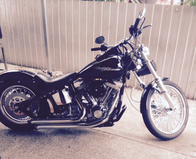

    im now the owner of a 86 FXST1340 5 speed. WOO HOO. went for a ride today awesome feeling getting back on a bike bloody hell have i missed it. i will post some more picks soon

  • fattatt
    fattatt
    congarts jg looks like a nice ride,evos rulecheeky
  • Choco
    Choco
    Nice ride go the evo's.
