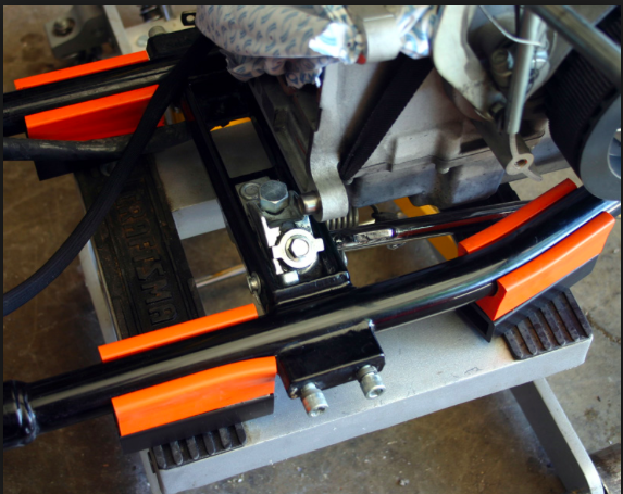

    I have the same lift have had it for years ,use on all sorts of lift jobs not just Harleys but about two years ago I got Harley haven
    to throw in the orange frame lift kit that Harley make with one of my orders , I should of looked at getting one when I got the
    lift ,makes it so much more stable and now sits on the frame not the shocks for the $30 bucks I think it was
    its a good investment I even use the lift pads on my bikes when there on my lift table too

    just had a look for the part number but came across this one my kit was slightly different but gives you the idea of what I am on about
    98965-99 is a dyna kit my kit came with two long orange ones than I just cut them in half to suit my bikes
    and thay will colour match your lift lol

  • perthhog
    perthhog
    that's them thanks fatrob for posting the pics jeez binnsy your bike must be low to have to mod the lift I don't use the the black spacers
    just the orange ones the bikes feel a lot more stable when you use them
