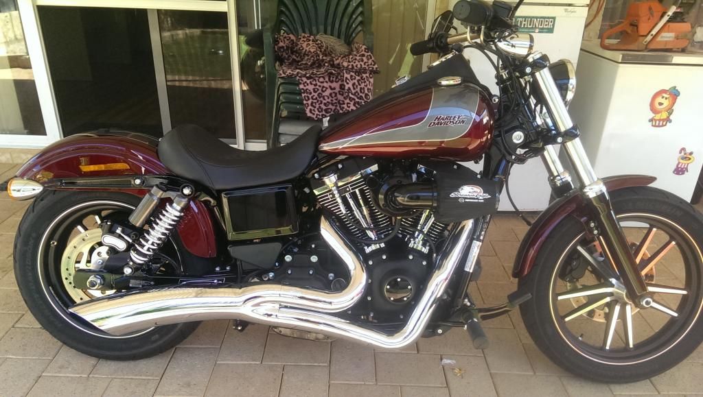

    what size rim is that 2hunji on

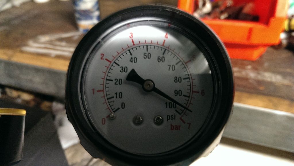

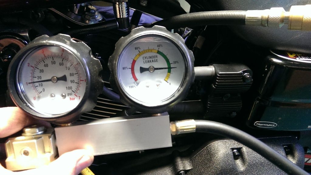

    got hold of a leak down tester today and pretty quickly ripped the plugs outa the RXBOB
    pretty happy with the results
    Did the rear Jug first
    [URL=http://s307.photobucket.com/user/Ando1450/media/IMAG5794_zpsjh5iwup2.jpg.html][/URL]
    Then The Front Jug
    [URL=http://s307.photobucket.com/user/Ando1450/media/IMAG5797_zpsrjxsox7s.jpg.html][/URL]
  • perthhog
    perthhog
    That's a good leak down test there ando was that done hot or cold if it was cold should be a bit lower hot good plan to check it and comp every now than

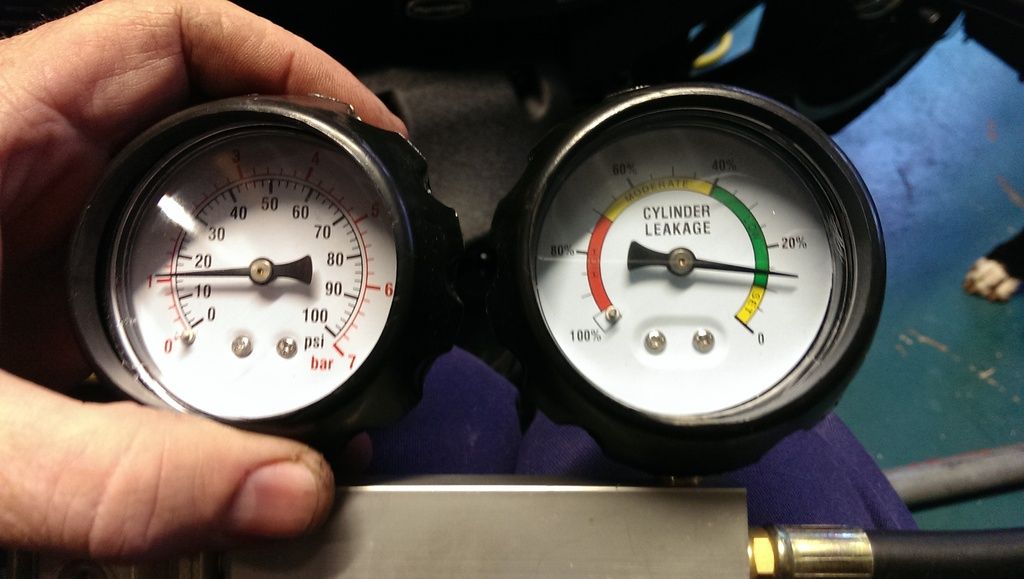

  • Ando
    Ando
    I think I have something wrong with the gauge as following the instructions I can't get any more than 15psi into the cylinders without winding the leak down gauge right of the scale, I did a comp test and had 198psi in each pot
  • Ando
    Ando
    went and played gauge swaps and this is what I end up with
    This is indicative of both cylinders just only got pics of one so it actually looks like 5%
    [URL=http://s307.photobucket.com/user/Ando1450/media/IMAG5800_zpsz9xht8rk.jpg.html][/URL]
  • perthhog
    perthhog
    Could be a gauge issu or the reg , what was your compressor opened right up sometimes you have to bypas the reg on the compressor
    But yep plenty of shit gauges and tools out there
  • FONTANA302
    FONTANA302
    You want close to 100psi pumping in there for the leak down then have 5% for an awesum leakdown.
  • Ando
    Ando
    Yep was a 100psi then dropped back to 95/96psi
  • Krash Kinkade
    Krash Kinkade
    95% seal good Ando, but like you say gauge's not always spot on, so like to double check find out where 5% is going, pull a bolt out the case where you time listen if hear air rings, take air cleaner off open throtle listen , intake valve, same up pipe.
