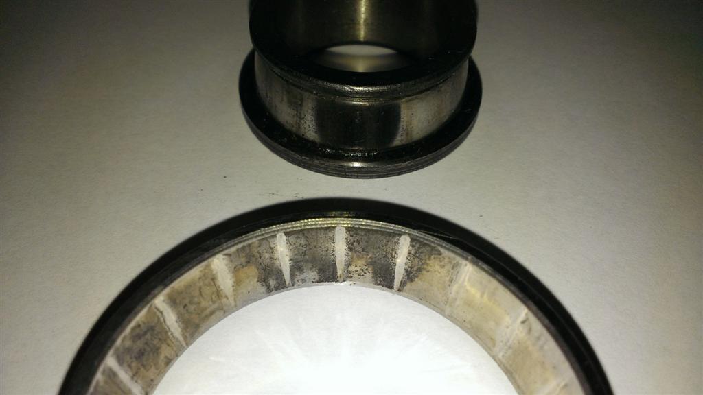

    These were taken out of the the bike we did the other week. Just to show what happens to bearings if left a bit too long between changes or adjustments.
    This is what hammered bearings look like. It was the upper bearing in the headstock. More movement from a improperly adjusted bearing leads to accelerated wear. There is evidence of water being present also. Note the grooves made by the rollers on the cup.

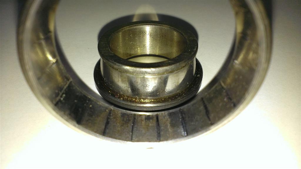

    See the pitting and damage caused by water and wear.

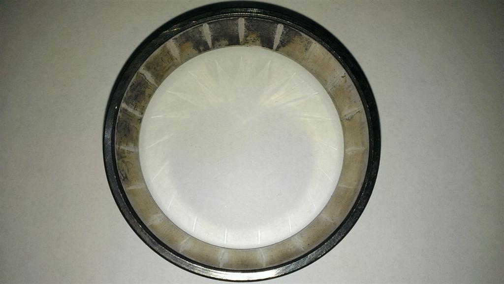

    The wear is a lot worse at the top ot the pic. This is where the most weight was place on the bearing.

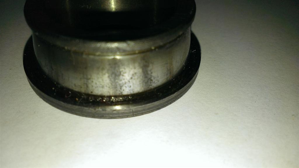

    Inner race pitting.
