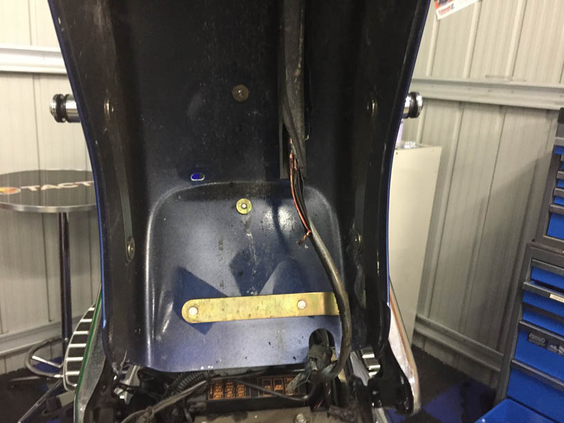

    So, I found the issue!!
    It seems the rubber protective strip that holds the cable off the back wheel had let go.  Pics and explanation below...

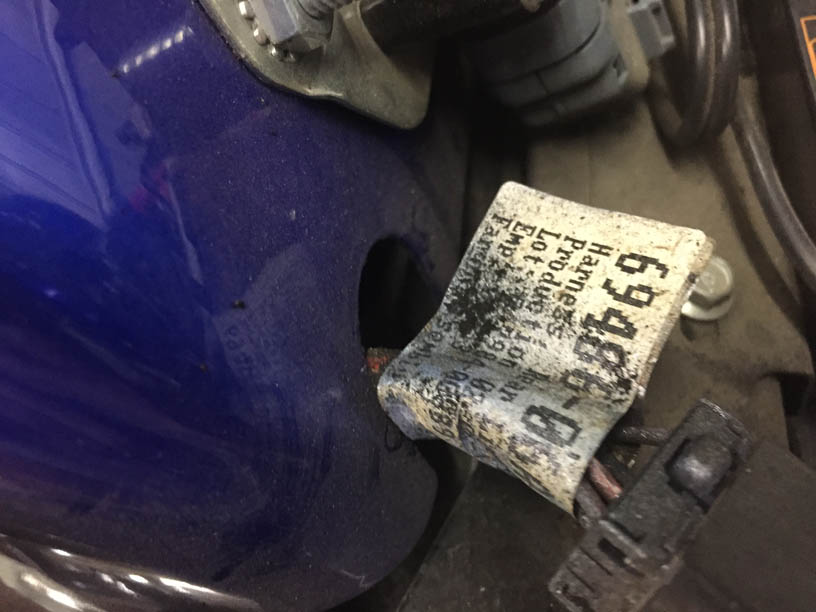

    So I noticed some black dusty suff where the wiring loom appears out begind the driver's seat.  Hmmm.... This don't look good.

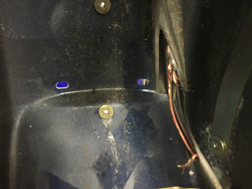

    So I lifted the guard and well, the pic speaks for itself.  The glue had let go and the cable had been rubbing on the wheel.
    OUCH!!

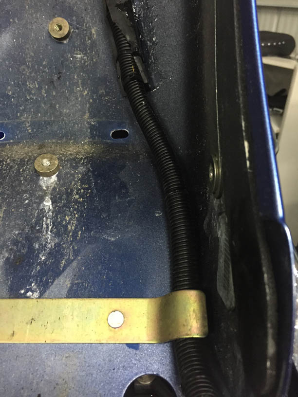

    So All fixed, glued back up with epoxy, and added a bit more protection with some plastic cable cover.  Should be good now.
