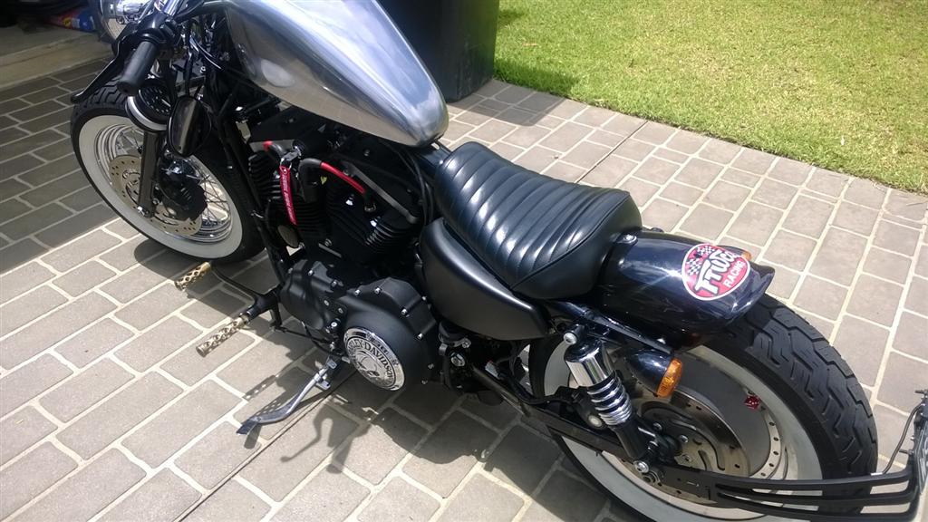

  • jinda
    jinda
    I cut the fender with a counter rotating circular saw. Took longer to mask and mark than to do the cut. It gave a nice clean cut without any damage to the paint. All that was needed was to protect the bare edge with undercoat then sand and apply the top coat. Used a fine brush for that.

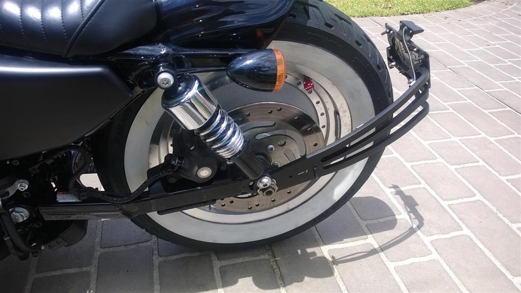

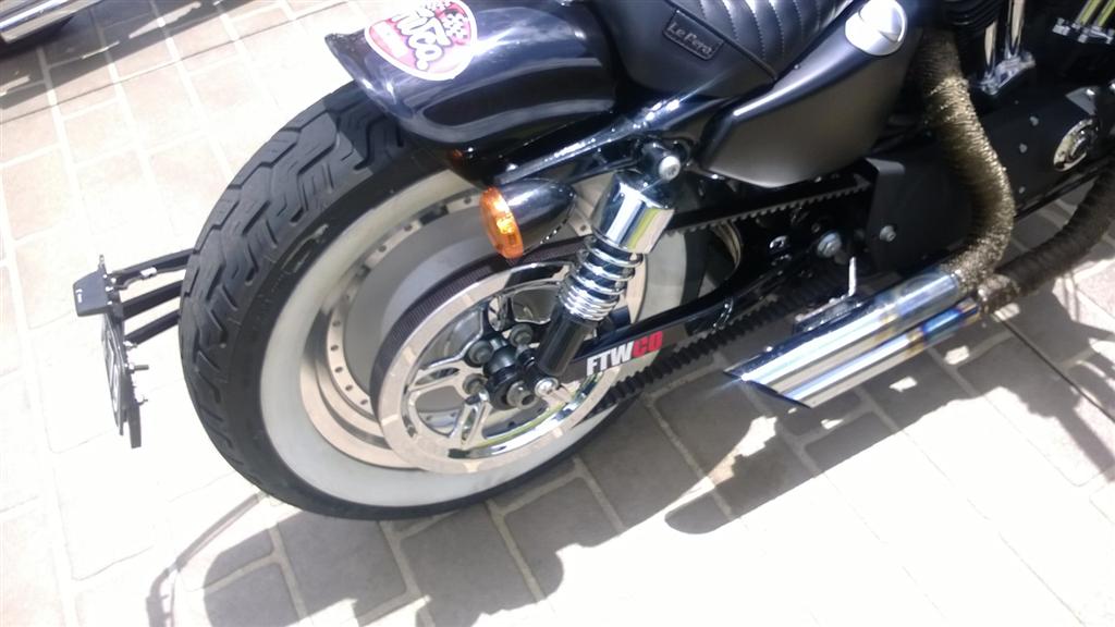

  • jinda
    jinda
    It's a LED unit I got from EBay $15. Tail/Stop light and numberplate bracket with rubber mounting block.
  • GT 1200
    GT 1200
    Checked out Jinda's setup on a recent ride. It looks good. yes
