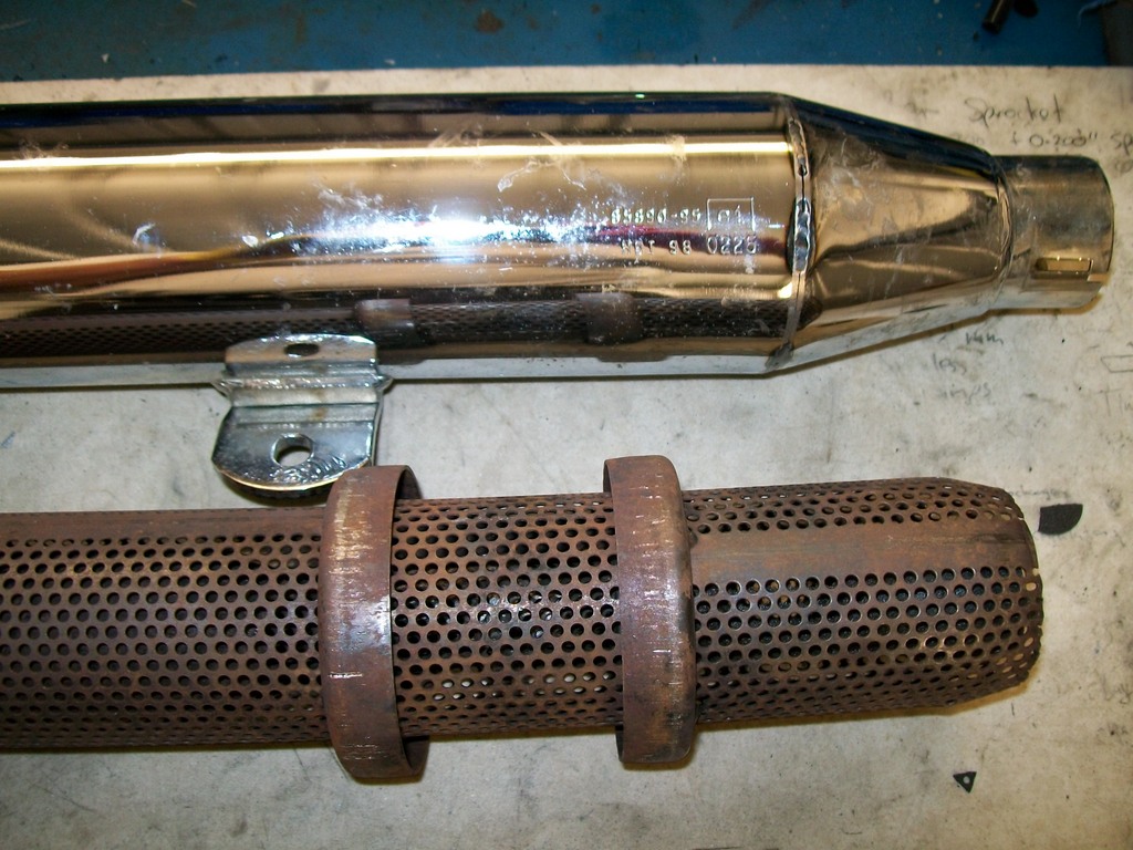

    Okay, so passed the EPA test today but the bike barely runs with the OEM baffle on it.
    I have a spare pipe so want to remove the internals.  I used a hole saw on both ends to get started and then a steel bar and a 2kg hammer to belt the baffle out, BUT they are not budging; they move maybe 3-4 inches either way but thats all.
    Is there something I'm missing here?

  • tussuck
    Right...all completed.  Even though I cut both ends with a 1.75" hole saw I still had to cut the muffler and pull the baffles out in the end (you can see why in the attached pics)
    Once I inspected the internals; it was fairly obvious that they would never have come out anyway as the two large rings are welded on very well.  Once I cut the end off then everything just fell out.  A few minutes with the TIG torch and the end looked good as new (ish).  I painted the weld in silver zinc and once the chrome cover is on you cannot see it at all!
  • paulsails01
    paulsails01
    Kuddoz Tussuck,
    Harley must have changed the design of the basic mufflers, the last time I did a set it was a case of simply hole sawing the end and then a bit of elbow grease. By the way, you can purchase a chrome spray in a can, don't know if it is heat resistant though.
