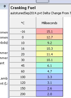

    Hey Guys,
    This is were it gets interesting, Dynojet are saying to increase cranking fuel by 2, however when I look at delta of new tune to original (pasted below) the delta's are positive in particular for lower temps, so shouldn't I be reducing cranking fuel mulitpliers?
  • robots
    robots
    hi,
    so at this stage the dynojet map provided has higher values than the stock map? yes reduce if trying to get back to stock map numbers
    the other things is from -16 to 30 degreeC the numbers should go more like 15, 13, 12, 10, 9 etc
    does get confusing sometimes reading delta and which map is compare or active
    thanks
    robots
  • art
    art
    Hey Guys,
    Created two tunes
    1) dropped Cranking Fuel values down by 2 to 30Deg Celsius Temp.
    2) Increased Cranking Fuel values up by 2 to 30Deg Celsius Temp.
    Tried 1) bike made a definite pop - I shut it off straight away so engine was cold and tried 2) bike started smoothly!
    Looks like problem may well be solved, it simply needed more cranking fuel.
    COuld be as map is based on SE AC and I have a big sucker, not sure if has a higher air flow rate ...
    Thanks all for your help!
