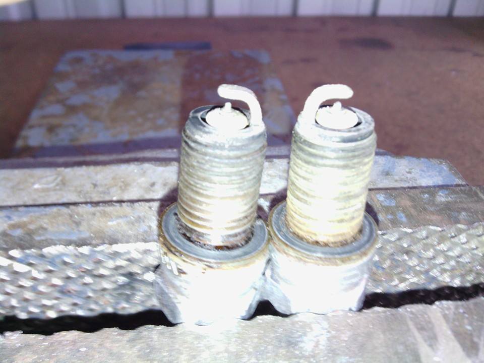

    I'm thinking mines running lean. Just put D&D Boarzilla.
