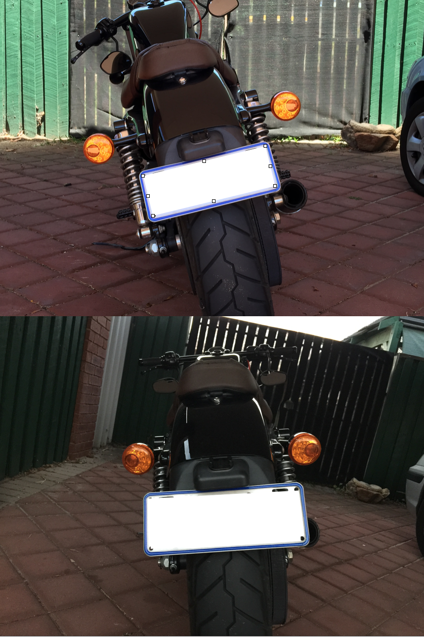

    I'm with Squids on this, got it done but a MASSIVE pain in the arse. Looks good though, the stand offs for other bikes (I got a pair for a dyna) don't just fit, a fair amount of grinding was required then cutting and soldering wires back together, also after grinding the stems spraying them black was a pain.
    Will post before and after pics later tonight.
  • Bandageboy
    Bandageboy
    Here's the before and after!

    Looks good mate.. The dyna ones look like they might be a bit shorter than the softtail ones too.
