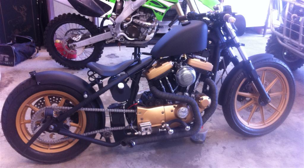

    I've been working on my first bobber build, an 86 Sportster 1100 for the last year and a half, photo attached.

    Nice ride. It's going to take a lot of un-modding to get it on the road though. Id be looking at what KiwiDave said - the fact that it doesn't happen all the time makes me think frayed cable though.
