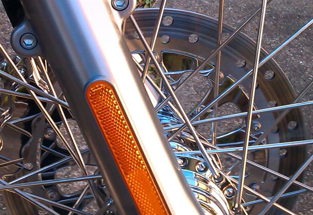

    Thanks for the replies, I think the buell rotor is 340 mm and th13inch one is 330mm so probably wouldnt work. TJU does the RC rotor you used have buttons  to attach the disc to the carrier, from what I have seen the RC rotors are lug drive so no buttons , or if they have buttons they dont protude out very much and wouldnt cause the clearance problems.The adaptor I,ve got is for relocating caliper further out for 13 inch rotors, they use similar for RC  13inch rotor conversion for touring harleys. As a matter of interest the Arlen Ness big brake has  a relocation bracket for a 15 inch rotor, and still uses stock caliper, I looked at that but only for 2000 up harleys, at around 270US not bad buying for large 15 inch rotor and relocation bracket, doesnt seem to be much info on them on the web........., anyway looking at it figured buttons would cause same clearance problem, so decided with bracket for 13 inch caliper, and find rotor with no clearance issues.....Thanks
  • TJU
    TJU
    No Bobbins on the RC rotor and on the other side the locking points seemed to be recessed ... hope the pics come across ok .
  • meanmother57
    meanmother57
    Thanks for the pics TJU, pretty sure that style disc would work with my set up, have Renegade front wheel with later style sealed 3/4 bearings,52mm OD, that take 2000 up rotors. Just waiting on transport to pull their finger out to get it registered, its an ICV done all the tests brake test, noise test , engineers report etc, they have had the documentation 2 months . I have a willwood 11 1/2 inch disc at the moment, but will be upgrading to 13 inch rotor once i get it on the road............. Cheers

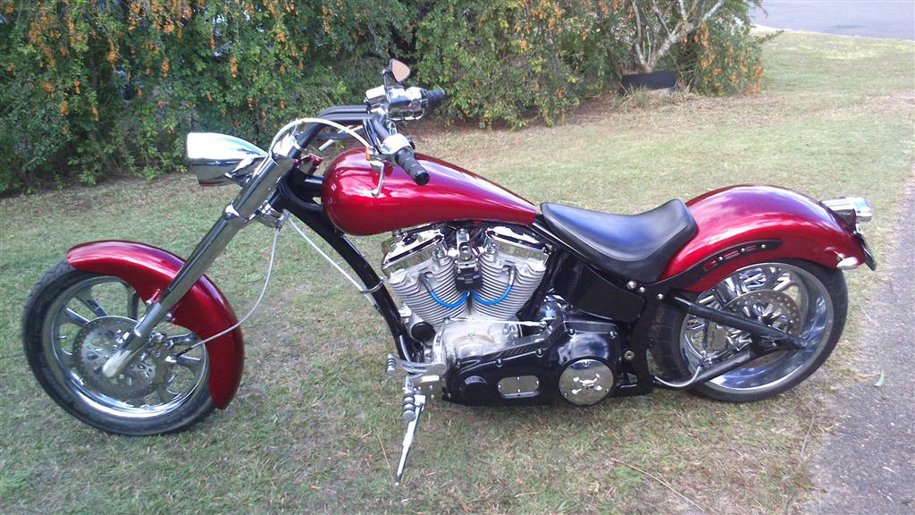

    Heres a couple of pics of my bike,  111 cu in Evo  S&S engine, Kraftech frame 38 degree rake , 3 degrees in trees, 5 inch backbone stretch, 2 inch upstretch, DNA inverted front end 2 inch over, Accessories HD 6 speed RSD transmission
  • TJU
    TJU
    VERY Nice ride you are going to have there ... are the pipes from a Breakout or simular ... hope you are on the road soon .
  • meanmother57
    meanmother57
    Yeah your right Harley Breakout pipes, had to modify them a little to fit in the photos they are breakout headers with cobra 3" slip ons with 2" baffle,at the moment have stock mufflers for noise test and until rego......Also have changed S&S Super E out for 45mm Mikuni, seems to have better throttle response just from the little riding I have been able to do.................Cheers
