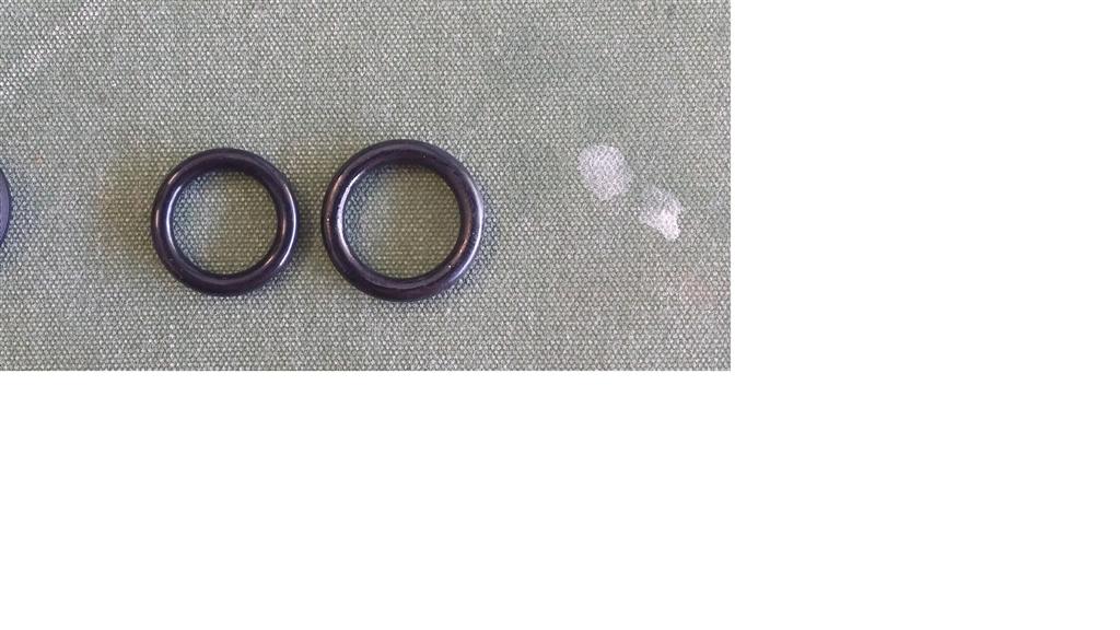

    Well I stripped down the master cylinder today and found the oring to be very loose so I got a rebuild kit, $47 from the dealer (small price to pay for functioning front brakes!). See the pic attached for the difference between new and old. Cleaned out a heap of muck and flushed and blead the system with new fluid and it now works like a treat! Thanks for your input guys.
