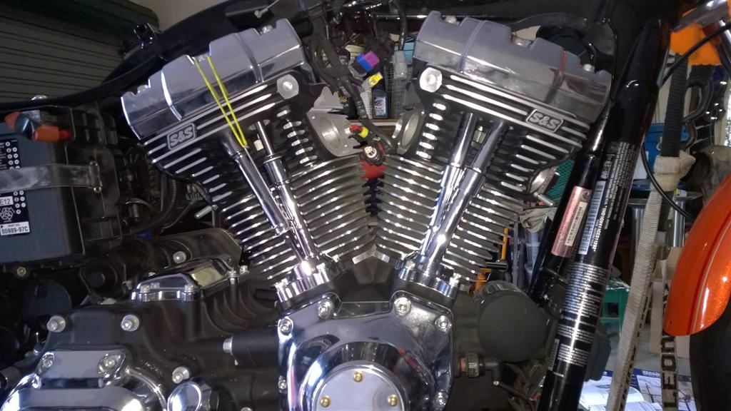

    Ive just finished fitting S&S heads, 583 cams, Fueling lifters , Zippers Cam chain tensioner..
    If anybody has fitted these heads, Im wondering on their choice of vent exit on front pot..
    There's 2 options, basically 2 holes [exits] , 1 grub screw..
    I thought I went with S&S's prefered option which doesnt allow it to vent out into air filter..
    Im not sure if I put the screw in the right hole after all,
    Ive got too much pressure in front topend, and its causing a bit /lot of smoke,
    mainly on backing off from high revs...
    My first thought was a stem seal, but everyone I talk to with much time with S&S reckon no way
    Anyway, front pots gettin a strip down on the weekend, will let ya know

    Yeh, he tends to agree with me.
    Ive done something wrong with breather set up

    I just read the info below and if you have the newer s&s heads with the short style breather you need there rocker covers. Not sure if this your problem or not but I also read they don't recomend claying the 1.940 intake valves. I had to open the valve pockets up to except 1.9 valves on my old cast 103 pistons
    Good Luck hope its a easy fix.
    http://www.sscycle.com/files/7713/7033/9919/51-1108.pdf

    Yeh that's the instruction sheet, comes with the heads...
    Where Im hoping I fucked up, is the bit about hole 1, & hole 2, breather holes
    Heading over to a mates shed [bike lift] after lunch to find out

    Made some progress this arvie
    took the front rocker box off, and swapped the screw from S&S;s preferred option,enlightened
    to the way the factory intended, breathing into the airfilter...
    Seems to have worked a treat, so far.
    But by the time we finished, it was tea time, so only rode it the 15 k home
    But I will go out on a limb, and say I think we had a winsmiley
    Now the Powervision isnt trying to tune a front pot drinking oil, it should be a rocket after test n tune day tomorrow

    its all good now
