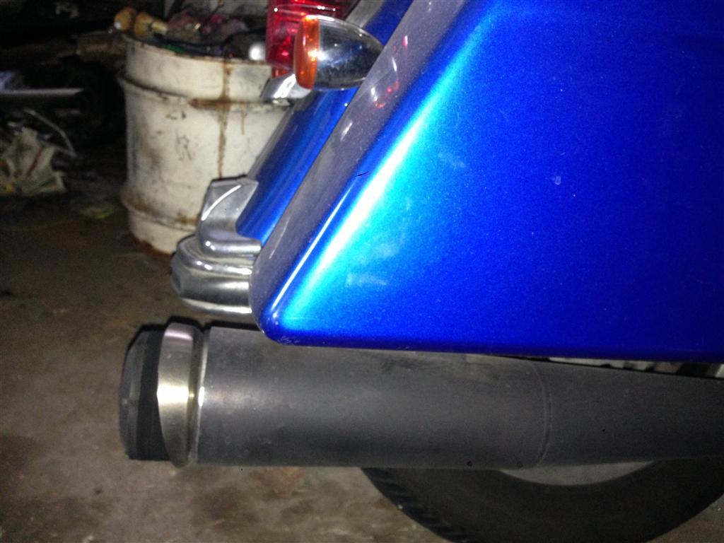

    Thanks for the reply...I am going to try to fit them into a Bassani Road Rage,short megaphone. Hopefully it will retain it's power but will quiet it down a little...

    I used a round chunk of aluminum for the end donut that slips into the muffler. Imagine a solid piece of round aluminum billet 3 inches thick with a 2 1/2 hole through the middle that slips into where the bassani cone used to bolt in. From memory there's also 8 x 8 mm holes that need to be drilled and tapped into the billet to hold the discs and open or closed end cap. Suppertrapp recommend 24 discs closed cap for full flow or 12 discs open cap for full flow My build required 26 discs closed for the best performance to 6200 limiter.
    There's a heap of my pics on Harley tech talk if you need to visualize how it all works.
