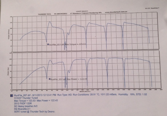

    Will try and load up a pic of my Dyno runs Speedzter , bare with me .
  • TJU
    TJU
    Ok , above the run in Blue was when it had the pc5  installed and of course pipes and filter and just the base run ... no Cams at this stage ... 73.57 Hp ... 87.46 Torque
    The run in Red after it was Dynoed ... 80.30 Hp ... 94.37 Torque ... 13 / 5 / 2013
    The run below was after i had the 583`s and rerun ... 84.55 Hp ... 100.24 Torque ... 30 / 8 / 2013
    And yes Speedzter this is the same map that is now being run with the latest upgrades ... 106 cu ... 79 cc Heads ... 50 mil throtle body and now 585 Cams .
    I realise of course i will have to have it remapped to suit new configuration but surley it shouldn`t drop out so much after hitting 160 , especially considering how nice it runs now Zero to that 160 mark .

    I'd be more than a little bit concerned pushing things running your old map.

    Thanks Speedzter , will look in to it ... just for the curious bugger in me , forget about the new configuration for a minute ... but did those Dyno figures for what I had done previously sound about average or a bit low to you , just always interesting to hear others opinions ... at the time most thought that they were good to pretty good for what was done to the old beast .
