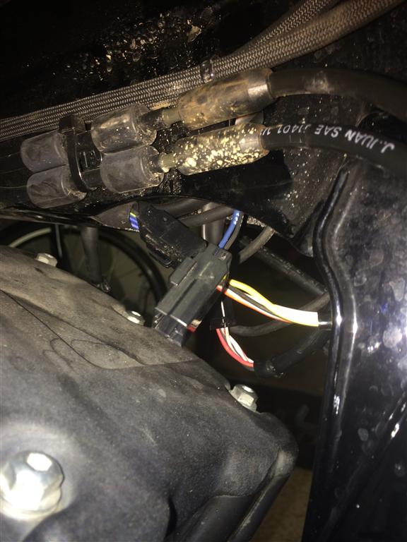

    Im fitting black fat mini apes to my bob, Ive routed the cables through the bars and hooked them up and this female open plug popped out, I didnt unplug it unless I did accidentally and I cant see up under there where it plugs back in. Any ideas? a spare plug wouldnt just be open like that under there hey? it might be the ABS going by the manual but the pics are in black and white so I cant see the colours . You can only see two wires going to it in the pic but it has three, two blue and a black. Thanks :o)

    Blue is power for running lights.
    Not used here.

    Oh so it is just a spare plug??? interesting its not blanked off. Three bare connectors in that female plug just floating around. Thank you :o)

    I've used that plug to power my GPS / USB charger so I get power when ignition on.
  • tussuck
    wrap it in insulation tape though just to be safe!
