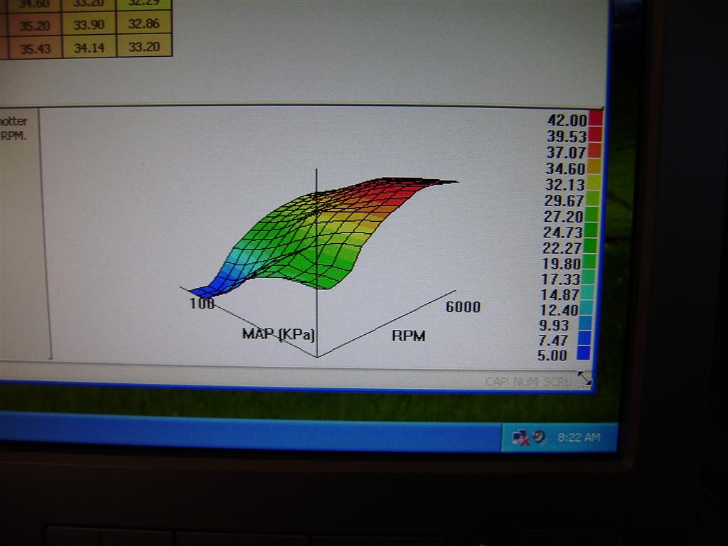

    hi,
    what you reckon of my front cyl spark advance?
    couple of little dips, but linear in general
    thanks

  • robots
    robots
    Hi,
    Yeah it whacks the VE at low rpm (leans it out), increase your VE (about 5%) in those area to richen up to help knock before you start reducing spark advance, check spark plug gap as well as could just be an issue there
    I found this site very good reading of an evening with a coffee and a couple of scotch finger biscuits:
    Megamanual.com
    For cars but its all the same stuff
