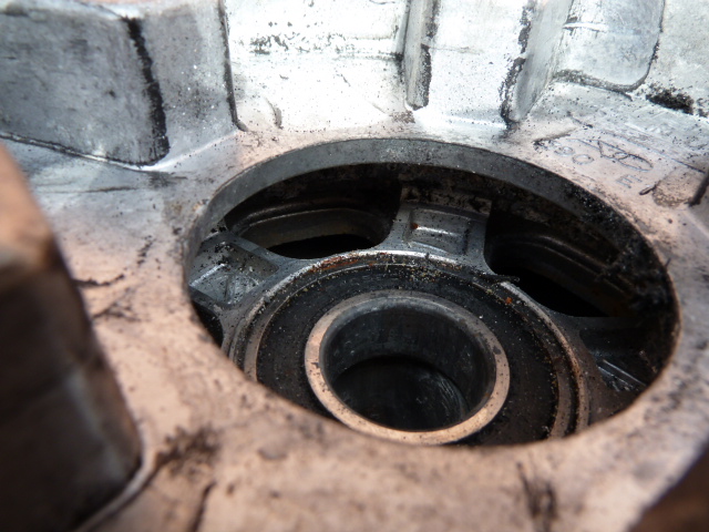

    Off topic, but talking about rear wheel bearings etc.
    Have a look at my rear wheel when i removed it to fix a flat tyre.
    I was really PISSED off.
    wrote letters to HD Aust. and HD USA about all the shit in the hub... and surprise, fckn surprise NO response.
    My rear hub had heaps of blast media? or other foreign  matter present.
