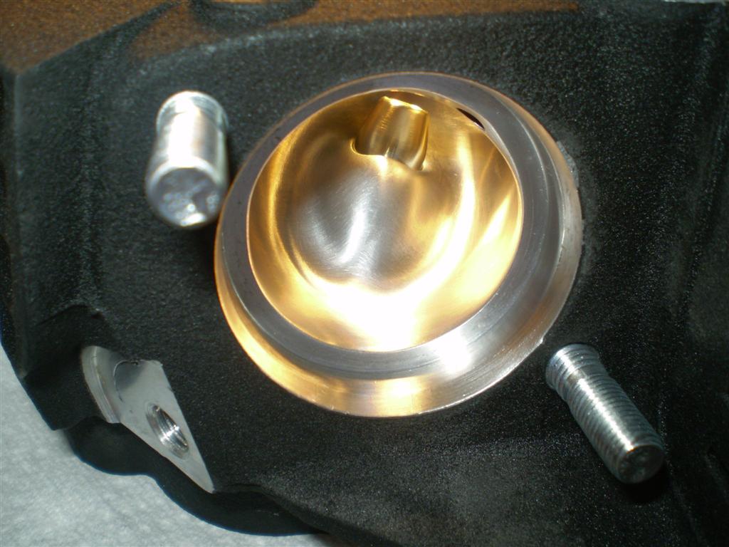

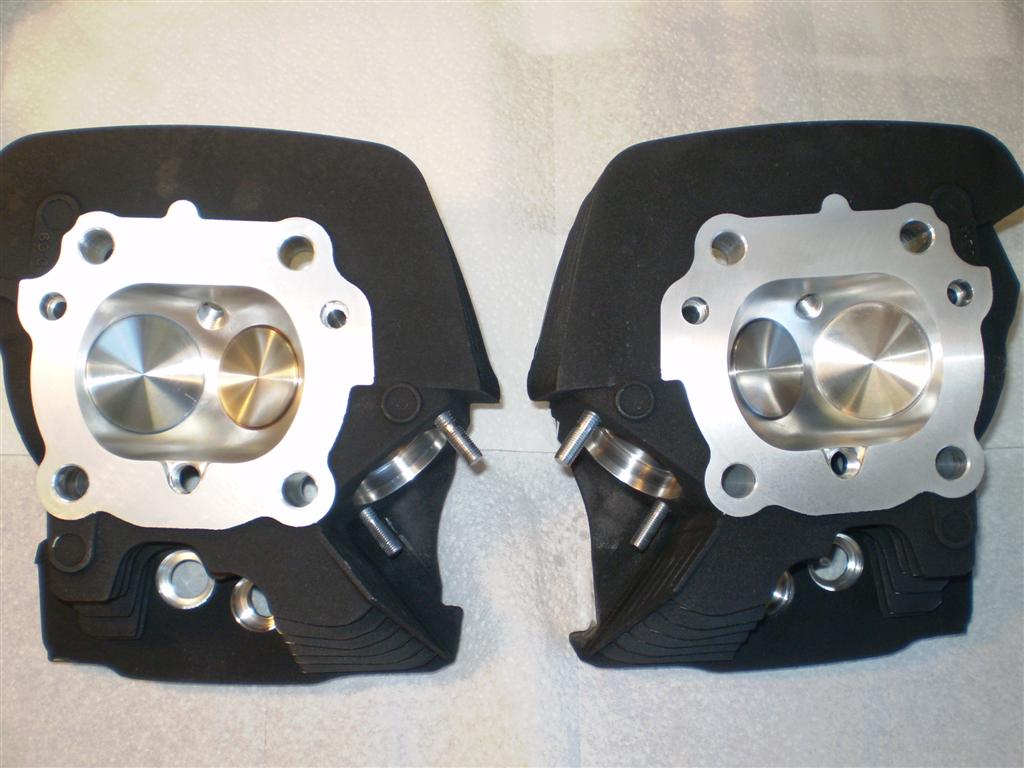

    I went with 103 cylinders, pistons, heads ported/decked (pic) and some cams.
    All in all seems like it will be decent upgrade for the bike.
    The heads were decked .010 so comp will be 9.93:1 with a .040 gasket. I am going to use Andrews 55's for this as well. I have the flow chart if anyone is interested.
    This is the first crack I have had at this and I wasn't after anything out of control.
    Something to widen the grin, stay rideable with some mid torque.

    that port in the pic looks downright sexy!
  • speedzter
    speedzter
    We must be a sick bunch when an exhaust port looks sexy !!!!
    Bucky, If you have the correct deck height, I would use an .030 head gasket to gain a touch of compression.

    Here you go Tuss, some more porn for you lol. Don't worry mate I thought it looked good too.
    I thought of the 030.gasket, I guess that would take it over 10. Does that effect reliability etc??? Some say yes, others no. Happy just to get it together and see how it goes.

    I started to get a boner when I saw the first pic ,,,, after the last pic,, I'm starting to lift up the fucking kitchen table !!!!

    Sparra-These heads are from Dunn performance. There are some others on here that have used them and have been very happy with the work done. Keith Dunn seemed like a pretty decent bloke and spoke to him a couple of times on the phone, so thought why not. Might be on a winner.
    After talking to Keith he said with the setup (duration etc) that the 55's would be ok. He has used them before on dynas and softails and had good results. He prefers 54's on the tourers etc. From what I could find out, the 55's were good from 2500-5000 rpm which I gathered on the highway would work ok. Happy to be corrected speedzter as I'm a newbie to HD engines. There not in yet so if something will work better there is always an option to change.
  • speedzter
    speedzter
    I'm not going to 2nd guess Keith. I would think he knows what works with his heads.
    I just see the TW55 as a fairly radical Cam in a Fatboy, unless you like to spend your time in the higher revs.
    An absolute perfect choice in my opinion (at 10.2) would be either a Tman TR625 (if springs OK) or a Wood TW777.
  • Ando
    Ando
    Yep I have used the 55s in a build and first I just fitted the cams and it didn't work until the later RPMS then went 107 and a comp of 10.5 and it hammered every where
