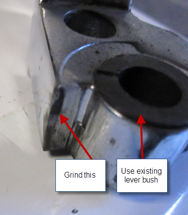

    Hi there.
    I've taken some pics for you. I bought some nice chromed levers after I broke the end off my originals. They caused the brakes to seize. No play at all. Couldn't see any difference. Use the dremel to slowly machine away the following surfaces. Doing this is designed to actually make space for the brakes to release. Take your time. I also used the existing lever bush for the pin. They work a treat now and look good to boot.

    Steelo, you are a legend! Thanks mate, I will get onto it, I have since put the stock lever back in.

    That is correct. I will attack my replacement lever with my die grinder and see what happens.
