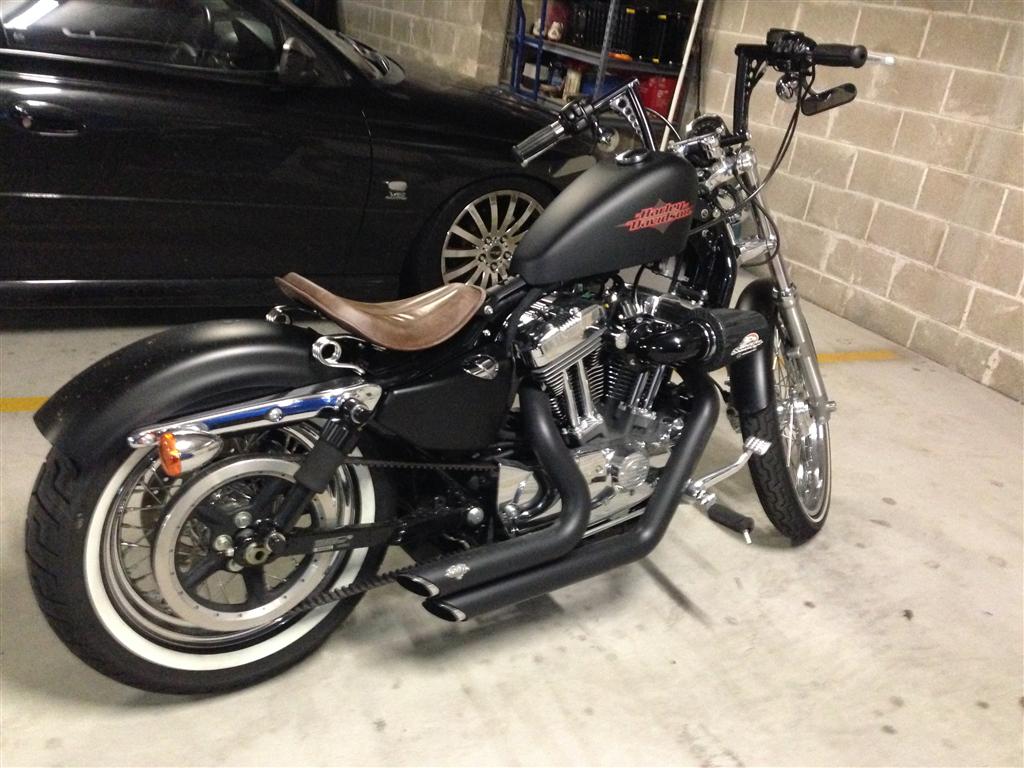

  • Harris
    Harris
  • Harris
    Harris
    There is a bit for messing around to fit a Springer on to a 2004 and Up Sportster,
    You need to move the Tank Back, You have to Grind out some of the Lower Tree on the Fork then get it Re Chromed or Powder Coated, You also need to make a 1/2 Bush to go under the Lower Bearing to lift the Frame Up, Springers also use diffrent Risers and Handle Bars, You also need a Caliper Bracket for your Brake Caliper and you should change your Front Wheel to a Wide Glide, Your Wheel has the wrong Bearings
