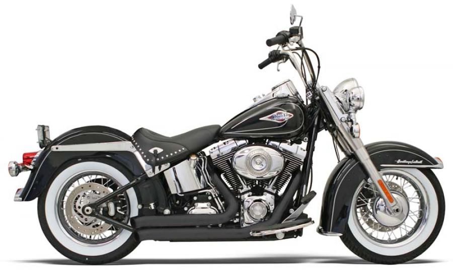

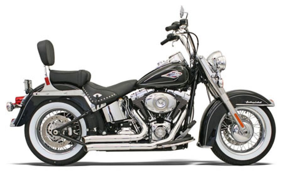

  • fmx austin
    fmx austin
    Bassani to do them for Softails with up to 200 Rear , There called Firesweep $495.00 and yes their Stepped for maximin performance
    [URL=http://s258.photobucket.com/user/raced86/media/12113D_zps8e813030.jpg.html][/URL]
    [URL=http://s258.photobucket.com/user/raced86/media/12123d_zpsb0a5bb48.jpg.html][/URL]
  • Ando
    Ando
    yeh seen them and they are a bit short, Like the pro street for the softy, I like the look of the pro street on the break out and the fact that the two header pipes look very close to the same length
  • Ando
    Ando
    off the Bassini web site and says will fit a CVO springer softy, don,t they have a 200mm rear end as well
