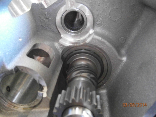

    im building an evo bottom end and it all went together well, bar 1 thing.
    The pinion bearing is protruding out the race about 5/16th i used the 1 piece cage with no thrust washers as per recommended everything else lines up fine, when i installed the tinner timken it was hard up against the flywheel so any ideas? Seems to be plenty of clearance everywhere else and rods line up spot on. Sp sprta stuck here.
    Any help appreciated, its no biggie if i have to pull it down again.
  • bobby bob
    bobby bob
    wrong bearing?check against old one if you have it.
  • hrafn
    hrafn
    nah, its the right bearing, looks like im pulling it down
