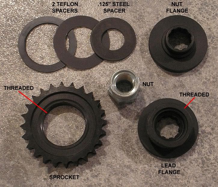

    My stock compensator was noisey, pulled it off and it looked ok, maybe the conical springs were stuffed. Fitted the BDL 24T compensator, half the size and weight. Discovered the clutch cable buggered so picking up newy tomorrow. Cross fingers all the gravel noise will disappear with new compensator.

       Thanks Oldtimer, I havn't found an exploded veiw of the BDL to see how it functions, do you know?    Where did you get yours?
      Got numerous drawings of the HD one, but none actualy show the "spring", I get the impression that they used washers of spring steel in that "lump of steel", have you looked?  I havn't had this bike long so I havn't.

    The cup that sits against the sliding cam holds the conical springs, if you want to go to BDL, Easy Riders and Rollies sell them in Brissy. BDL is a compression type compensator, it uses two teflon discs, one for forward motion and one for rebound.

    The lead flange screws into the sprocket sandwiching a teflon washer and the nut flange goes into th other side of the sprocket sandwiching the other teflon washer, with forward motion and rebound the sprocket will screw and unscrew compressing the teflon washers. The HD compensator uses disc springs and ramps to achieve shock proofing. Check the link on how it all gets assembled, http://www.beltdrives.com/pdfs/cs24acs25a.pdf
