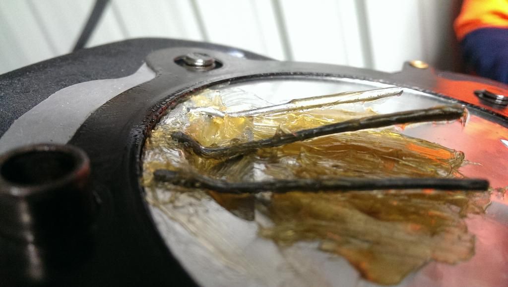

    checking Piston valve clearance of the 2" intake valves
    [URL=http://s307.photobucket.com/user/Ando1450/media/IMAG0734_zpsd18b406e.jpg.html][/URL]
    [URL=http://s307.photobucket.com/user/Ando1450/media/IMAG0733_zpsd12afdfa.jpg.html][/URL]

    we are using Manley Valves not sure if there is any or much difference between them and the AV&V valves
  • Ando
    Ando
    just spoke to my head man and it is a 1.625 exhaust valve.
    Valve to valve clearance has been checked and is all good

    evo heads suffer from shrouding one one side of inlet and exhaust  , they can be easly modded with correct items ,  then some time with over size valves you can also get bore shrouding , restricting flow , inlet valve size is normaly determind  by bore diametre , so big some times is not always better , in the case of the 3.927 bore in this case 2 ''  will be fine

    here is a couple of assembly pic's of checking clearances
    [URL=http://s307.photobucket.com/user/Ando1450/media/IMAG0823_zps7954b6d9.jpg.html][/URL]
    [URL=http://s307.photobucket.com/user/Ando1450/media/IMAG0822_zps7ef6da36.jpg.html][/URL]
    [URL=http://s307.photobucket.com/user/Ando1450/media/IMAG0810_zps2a426122.jpg.html][/URL]

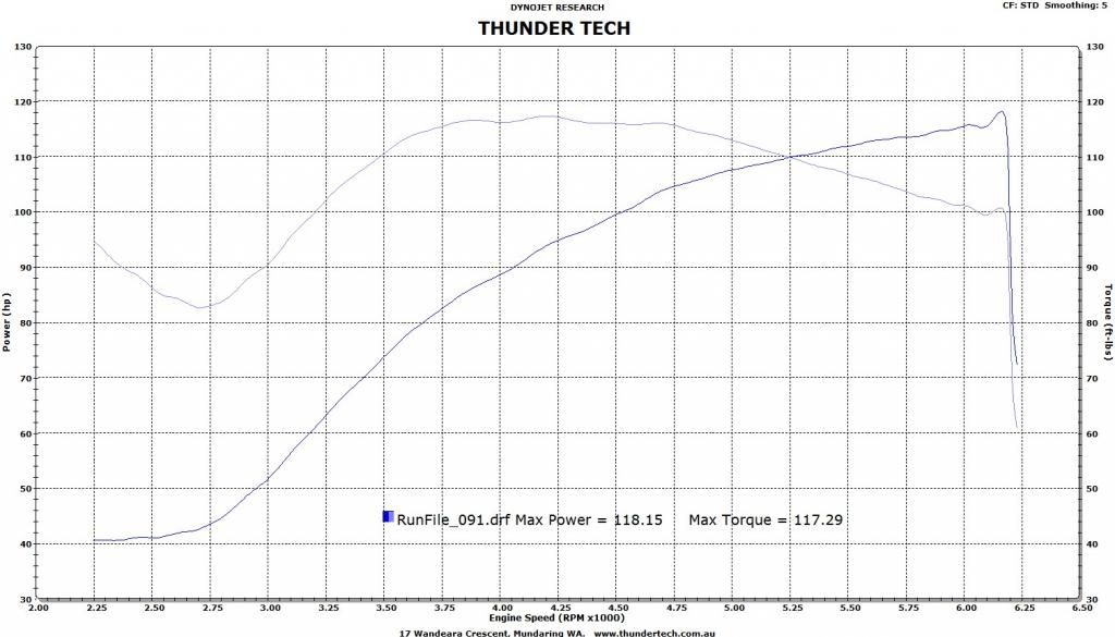

    the final results this is a pleasing result if ya keen on numbers ad 10% for a true comparison
    [URL=http://s307.photobucket.com/user/Ando1450/media/Dave_zpsea3709e3.jpg.html][/URL]
    Look at the sheet I reckon the way it makes power all the way to the rev limiter the heads are doing there business and its other factors that are stopping it from making any more HP
    Also has a broad torque curve and its set up at about 10.6/1 comp

    Awesome numbers for a 107. Why the dip down low ? Starts good drops off sharp then comes on strong.

    very nice figures ando , quality job
