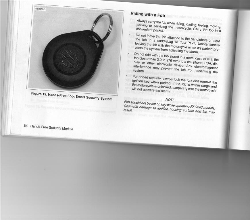

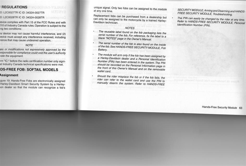

  • Will67
    Will67
    here ya go hope this helps it also tells you in the owners manual how to program it this info is from a 2010 softail manual

    If you don't have a PIN the dealers can't/won't assign it and that is a whole new ball game.
