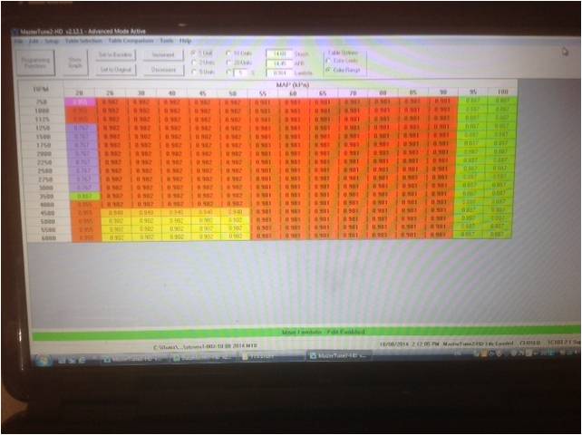

    Ok
    so I read those pages and think I get it
    Opened library file. Changed settings upto and including 90 kPa to 0.981.
    95 kPa would not go higher than0.940 and did not touch 100 kPa
    table selection adjusted PE to 10000
    now can I make a cal using data collected today or do I have to flash this cal to bike first then collect new data after that?
    cheers for your patience Hilly
    owe ya a couple of frothies for the advice

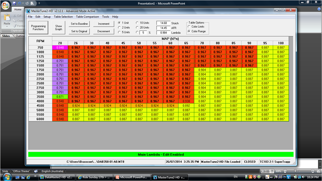

  • Builder bob
    Builder bob
    ok hopefully the pics come up ok
    update on where  am at for other dummies out there and maybe some feedback from the ons in the knoiw
    followed Hillys advice and read then re read then re read again select pages of the manual.
    Did the cam selector as described and set new cam details to open 5 close 3
    flashed to bike then went for ride  idled ok but heaps of decel popping that was not there in cal dab35801ao
    so reset cam to as per selector open 4 close 3
    selected base cal =DAB358-01-A0
    set main lambda values under 100kpa to .981
    set pe to 10000
    saved then flshed to bike

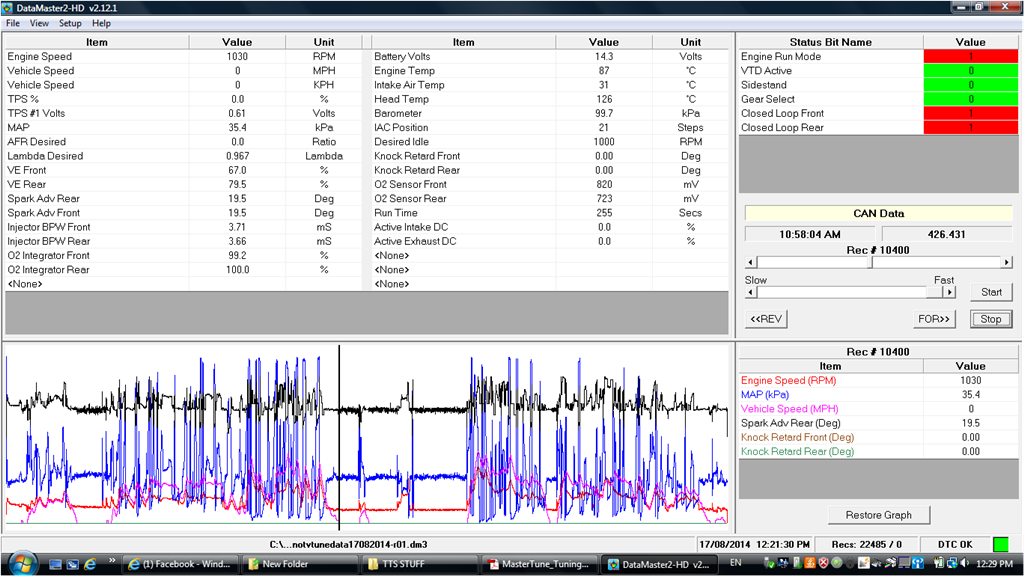

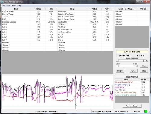

    then set up as if vtuning with computer and let bie come upto temp and idled to see if collecting data correctly ( see pic 3 )
    took a while for o2 sensors to line up but appears to be getting data ok

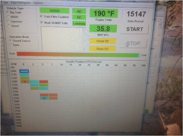

    closed that and opened flightrecorder
    followed docs simple set up instructions as posted earlier some where on these forums
    plugged dongle in and away i went
    up and down a few hills. plenty of throttle holds etc.

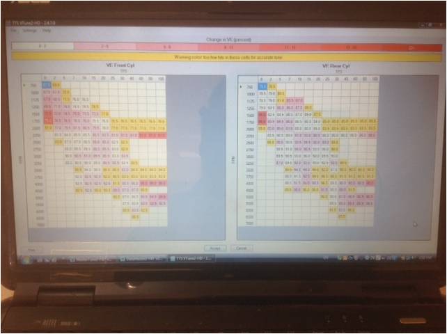

    30mins later am blending tts cal with my data (see pic 2)
    blended data and created new tune. (see pic 3 )
    my questions are is this ok data?
    if I flash this tune to the bike will it be better than stock cal 358......?
    can i leave it at that or should i continue wih runs to improve as there is pleny left in the bike?
    If this is enough for now do I just flash it to bike and leave it at that . no moresteps or do i have to change settings backj ?
    ps. after setting cams back vertually no decel popping at all
    sorry bout million questions but tts is really not as simple for non mechanics but now i have it want to make sure the bike is running ok before heat of summer hits and i hink once you get it right a few times the possibilities are many
    cheers for any replies
    bb

  • Arron
    Arron
    Theres a small amount of KR in the pic below , have zoomed in on where it is in the graph.
     - Arronkt - Photobucket
     It's the green line at the bottom , 1 deg of knock.
  • Builder bob
    Builder bob
    Thanks Arron
    Now I know what to look for will keep an eye on future v tunes. If I get any then will be back here I'm sure to ask how to fix it.
    Cheers again

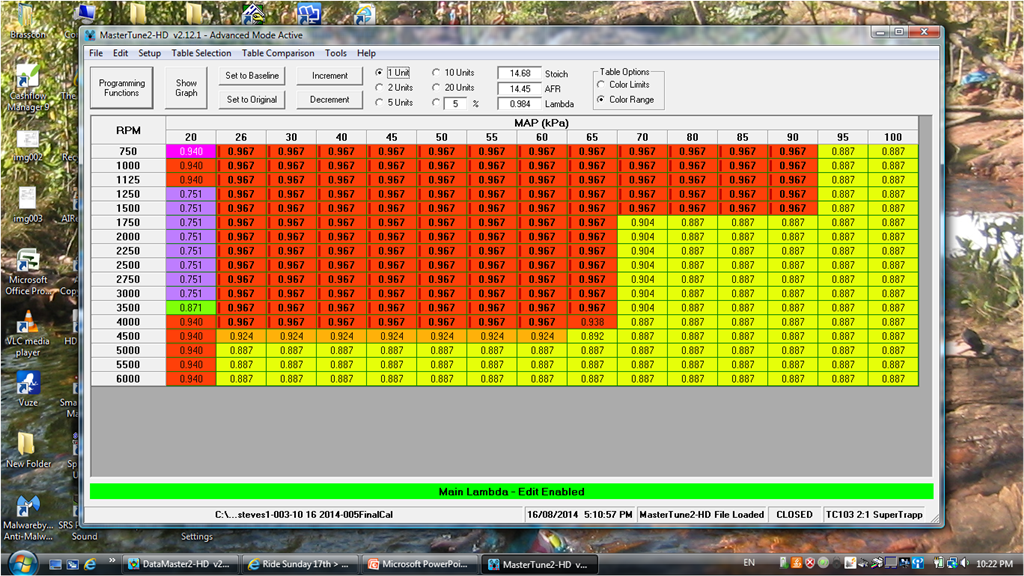

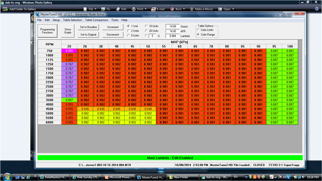

  • Builder bob
    Builder bob
    First pic is TTS tune DAB358 etcetc
    second is final cal as set back to original
    Third pic is last vtune
    last pic is a data collection run after final cal flashed to bike

    Hi guys
    couple of queries for any TTS tuners.out there.
    I startd with DAB358 as my starting TTS tune. flshed it to bike. ran really well with this tune even though the pipes are different.Started vtuning and did a few runs 5 or 6 @30 mins or so.
    Was happy enough but didnt notice any seat of the pants improvement.Then today i reset final cal afr to original and PE to original as per instructions then flashed to bike.
    Started her up and thought was a little tinny sounding. Rode OK but to be honest i think the original DAB358 cal rode better by very small margin.Is this possible.I notice the values in the cells are very similar. Also how is it we reset all the values to original doesnt that render the tuning part invalid and a waste?
    Each time you blend a new tune isnt it supposed to be minor improvement and a bit closer to perfect AFR for that cell. if so why reset all back to original?
    Dumb builder trying to make sense of mechanics. gotta be a great laugh for those that are fluent in this.
