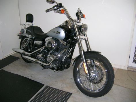

    On a standard 2008 fxdc what would be the minimum size apes you could put on before you needed to start replacing cables due to length restrictions, was thinking of going to 12". Have heard that size is still legal in South Australia.

    I've fitted streetbob mini apes on my 2012 dyna with only a re routing of the clutch cable.   Mind you, the later dynas have mini plugs, so it's a quick swap over, no plug ends to undo. You can have the bars for $50 .They are internal wire only.

    That does look good and thanks for the offer, but I think I will go 12" and Putt on some braided lines.
