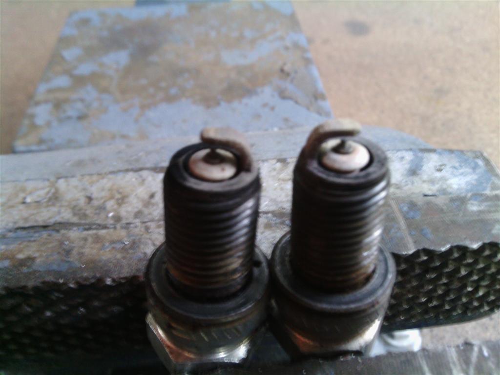

  • Dutchy Hoogen
    Dutchy Hoogen
    Could not get my phoe to put text on anyway. This is not good photo but my plugs are light tan colour almost yellow. I'd say shes a bit lean.
  • robots
    robots
    Hi,
    Light tan is good, if you have manual it has a good page on what you look for with spark plugs, if you concerned add 2 points across entire VE table for front and rear cyl
    Thanks
    Robots
  • Dutchy Hoogen
    Dutchy Hoogen
    Thanks Robots. I assume its better to run a little rich than lean as far as engine damage gos. I'm going to ring Neville Lush this week to get it tuned properly.
    I have the 120r engine heavy breather 58 throttle and I've just changed from standard fatbob headers with cat etc removed and S&S slipons to a D&D boarzilla. Dealer only put download in when engine installed. Tune was not perfect before but bike is worse with new pipe.
    With new pipe bike splutters and coughs if engine is not fully warmed up, will do it too if left sit for an hour after ride.
    Pops and on decel every now and then.
    If cruising and excelerate it will splutter or have no power for a second before coming good.
    Coughs and splutters if I throttle off quick and throttle back on. Like when going hard in to sharp corner.
    No problem if going hard through the gears.
    Pretty good on fuel. Doesnt use much more than the standard bikes unless ridden hard.
