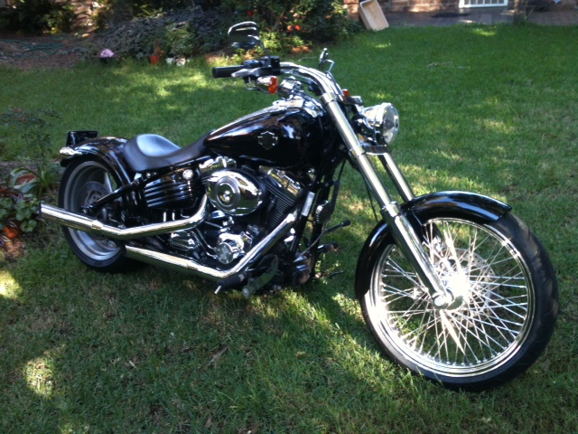

  • Wynchester
    Wynchester
    The old stock wheel looks a bit sad on the ass now.
  • gidgi
    gidgi
    very cool pic mate looks the goods. they are so much like the Breakout the same frame I`m told ,my mate was told the Breakout  rear fender fits straight on the Rocker... cheers
