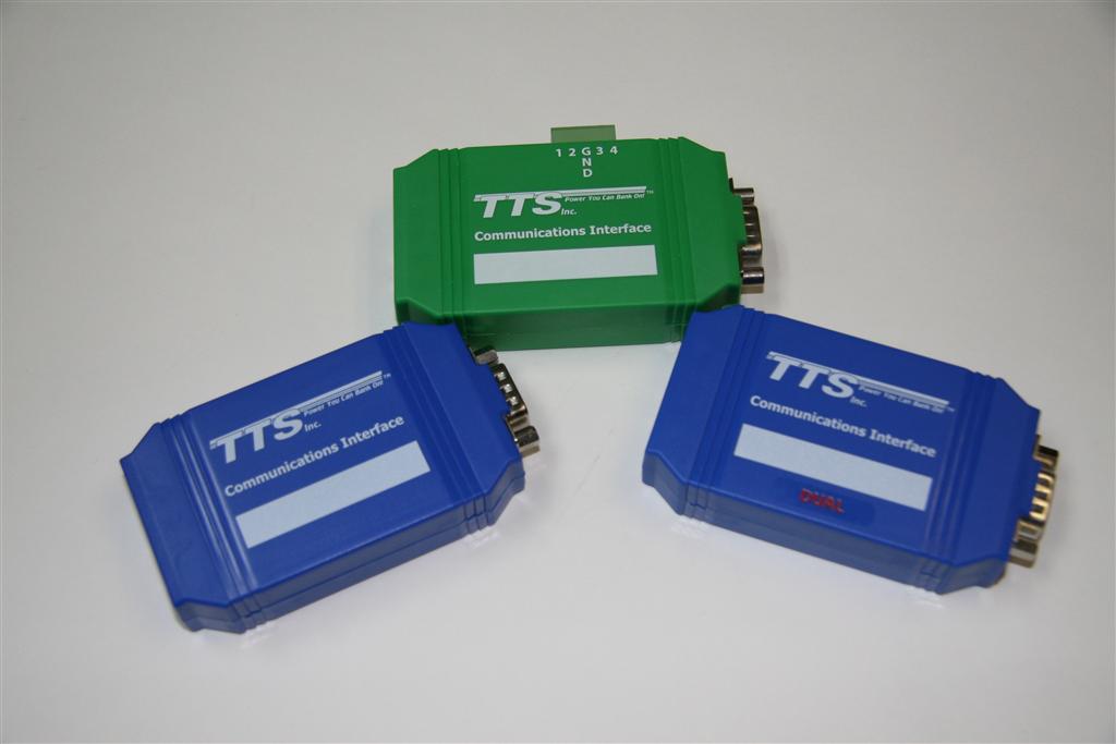

    Well its been a long time coming but we are now accepting orders for the Newest version of Mastertune. This does not replace the current product but it is yet a different version of it that has more features. The new part number is 2000012 and cost is $595.00 USD. What this unit offers, that the current product does not, is 4 additional channels of analog data that can be recorded. These 4 channel are 0 - 8 vdc inputs that the user can hook-up to what they want and can enter the channel information into DataMaster2 so it will record them at the same time as it does all the other information. This allows all features in DataMaster2 to be used with the analog data as well as the rest of the data that is in DataMaster2. Units will begin shipping end of next week. The new unit is in the green cases.

    Steve in layman's terms what will this give my old 07 bike that the old black unit doesn't.
  • speedzter
    speedzter
    My take on this is the only possible use you may have for this on the street is to log W/B sensors as well as the stock N/B sensors.
    But you would still need an external W/B controller.
    Possibly drag racers would use the function to log EGT's, and to measure clutch/wheel slip for clutch tuning, but most already have the tools available .
  • Steve Cole
    Steve Cole
    This unit allows for the 4 channels of data to be shown and recorded with all the other ECM data so you can see exactly what is going on frame by frame. This does not exist from anyone else on the HD market. What will it do for the normal bike owner who just wants a tuneup, not much as they really do not care BUT, for the shop owner/Tuner it allows them to see things and do a better job tuning than they could before. It will also allow them to work quicker as all the necessary data is in one place all at one time. While it's not for everyone, it has it's place with Racers and shops we feel.
