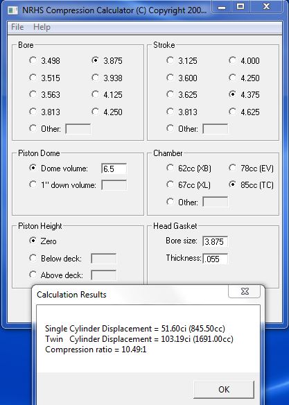

    The kit gasket is already .055" , piston 6.5cc, too much for little old 54's.
    Would like to see a current compression test. Anyone with Stg 4 here checked ?

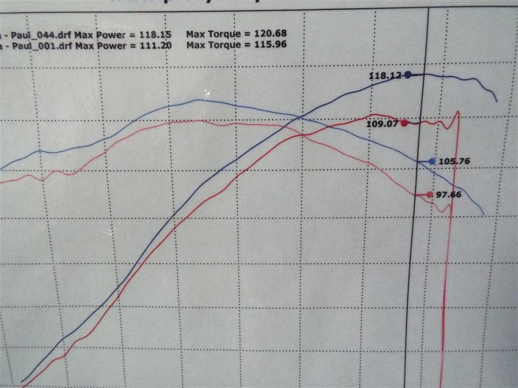

    PaulT
    the red was how it was from the dealer off the shelf tune, the blue is after Pro Cycle dynoed it. Pretty tidy figures hey?

    PaulT can we see a pic with the scale ?
    Hilly, not sure what figures your using ? I'm asuming zero deck

    The people on the US site are also recommending to get it tuned by a proper tuner!! Is that The tuner it was taken too or still better around you reckon?When you look at the full chart not a lot of difference in the tuned and the canned map except the power and torque final readout

    Get a Tman (nice cams with broad power range and quiet), S&S or Andrews cam that suits your present 10.5:1,  get a 2;1 exhaust longer rather than shorter which is also smaller rather than big diameter, a smaller throttle body if it wll still fit (a bored to 50mm and well ported standard one or a HPI will out flow the harley SE 50mm and have better response). Big exhausts, throttle bodies etc etc etc are OK if you want to ride around at 4000-6000 RPM in first or second gear all day, try to resist the urge that bigger is better. Quick easy way to do it yourself and keep the costs down without having to take the heads off. Get your money back by selling the over the top bits on there now. If you want revs and power a second hand japa will do it better and not be much different in cost to what you might have spent just on the top end so far if a dealer did it all for you. Spend that much on modifying a jap motor which is half the size and see how fast it will go. At the end of the day it is a heavy bike with an air cooled twin cylinder motor not far removed from the first Harley OHV big twin made around WWII in it. NRHS I think it was did some dyno tests on exhaust cones and some other stuff, most of it is not worth the money, you might ever lose a bit of power. Still love mine as well even with all its faults.
