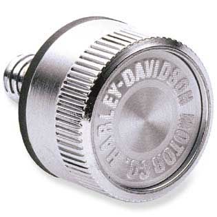

    replace it with this one if you swap seats a lot.
    think it's called "quick release seat screw"
  • brash
    brash
    some asshole might steal your seat while you are at the pub or something though.
