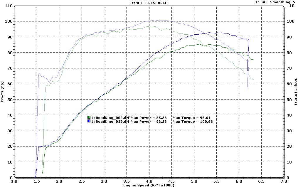

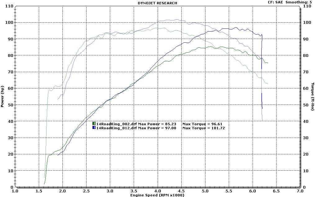

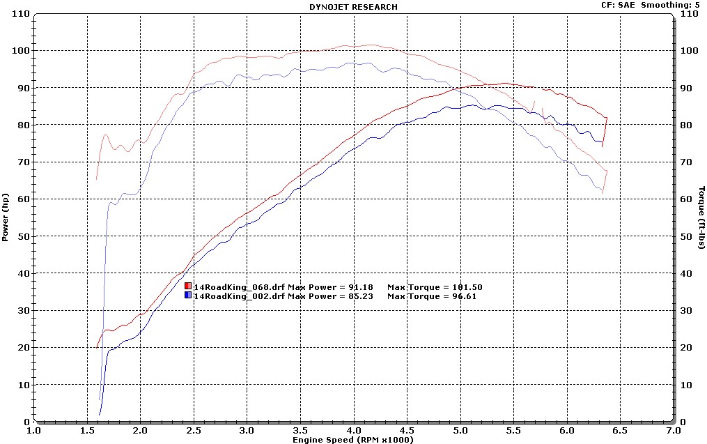

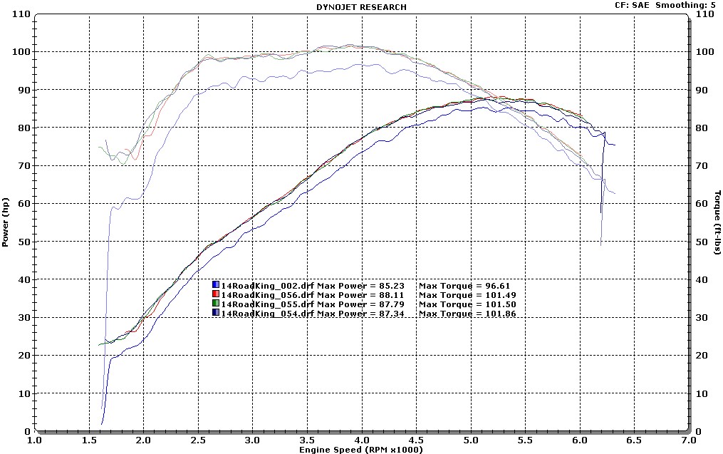

    Well the first round of testing here is finished, more to come in the future. We took a new low mileage 2014 RK 103 HO and added an air cleaner, Fullsac head pipe and Cycle Shack 4"slip-ons. Then created a finished tune for it. So this became our baseline bike for the development of new tune files for various camshafts. Once all testing was completed we return the bike back to baseline and retested to make sure we could repeat the dyno runs from before. The bike dropped right on top of the first set of baseline runs, so life is good.
    First graph is Basline and SE 255, then Basline and 254E last Basline and 259E

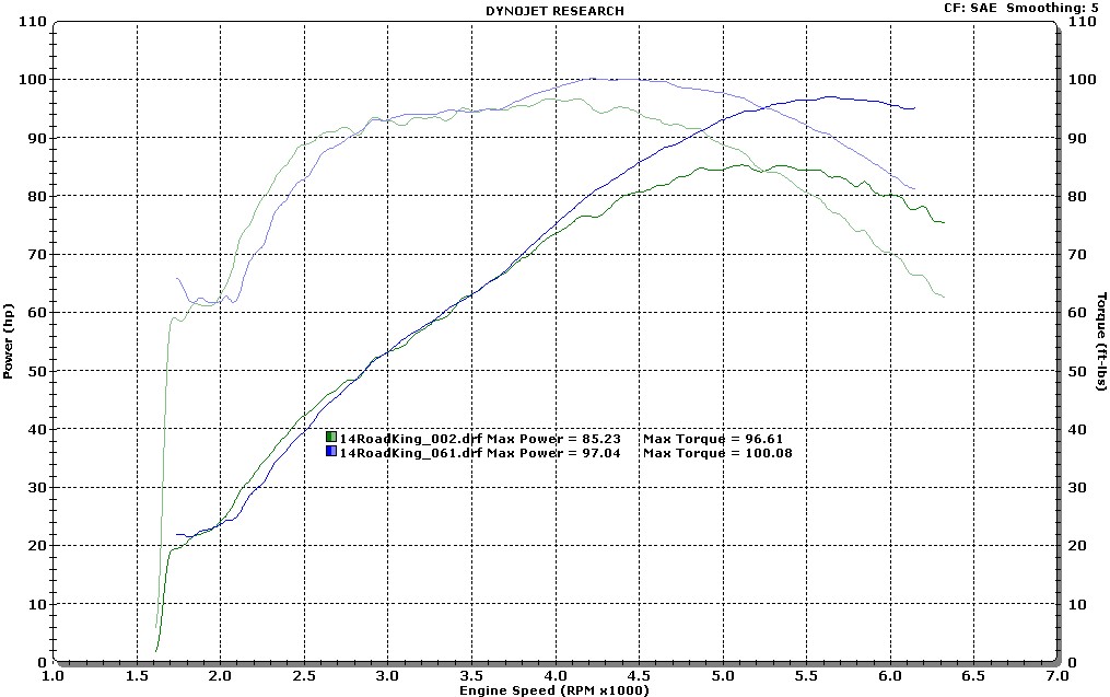

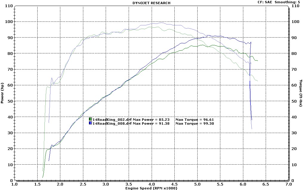

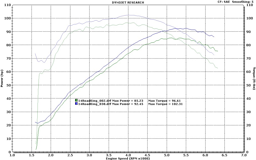

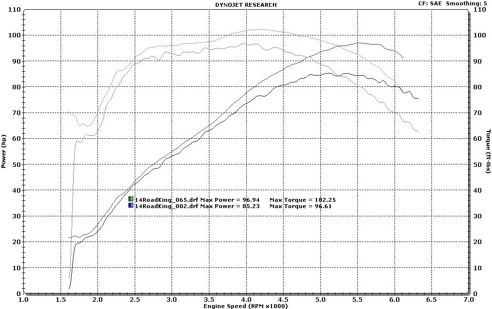

    Next up were Andrews Cams
    Baseline and 37H
    Baseline and 48H
    Baseline and 54H
    Baseline and 57H

    All in all we did 18 camshaft test and tunes and these are just a few of the results for you guys to look over. While your results may vary some it gives you a good idea of what we do to develop base calibrations and the care we take when doing it. This is the same bike over and over again with the final test of it going back to baseline. All in all this took about 4 weeks of work. Next up we are switching to the 2014 Shower Head 103 and going to repeat it all over again. IF we can we are also trying to find a 110 to repeat the testing with too.
