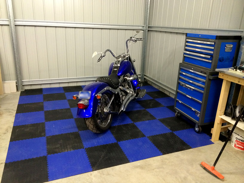

    Well, my new floor is in, and teh Table Lift will be here monday!
    Then, I start pulling her down in prep for the upgrade!  Should be fun!!
