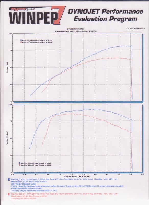

    Stephen they should come with standard baffles, quiet baffles are a reasonable option, they don't actually quite them much but the deepen the tone a bit. My quiet baffles actually broke, they aren't a very sturdy piece of engineering. Being a metal worker I made my own. Used some stainless perforated tube and modified the baffle end caps to make the perforated section as long as possible then wrapped the perf tube with fibreglass matting. Still loud but deeper note and dyno'd up nice
    all negative comments asside, I loved mine. Yes, noisy but enjoyed them whilst I had them. Was told I would loose 10% torq and HP.
    I had the A/C changed, Short Shots and PCIII and dyno tuned by Patterson's in Bunbury (Duc dealer)... was very happy...

    My dyno results, before and after tune. Not too bad with the short shots
