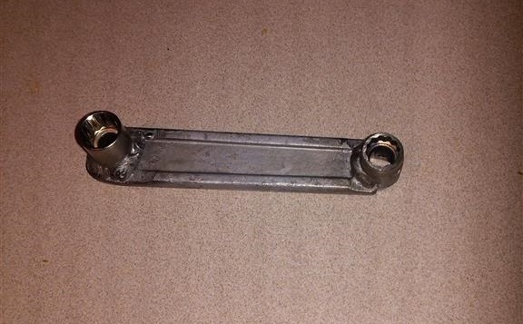

    Use two 3/8 drive sockets the correct size, weld a bar between them, and grind down the sockets as needed for extra clearance.
    I can shoot you a picture if needed.
    Great for rocker box work.

  • markwoumla
    markwoumla
    Ha Speedzter, How about posting up a pic of your home made torque adaptor for those of us that have some welding skills and a welder !!!! Robots , I thought welding would be right up your alley !!!!!

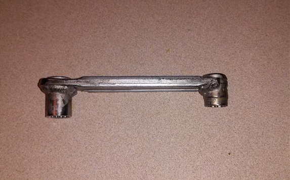

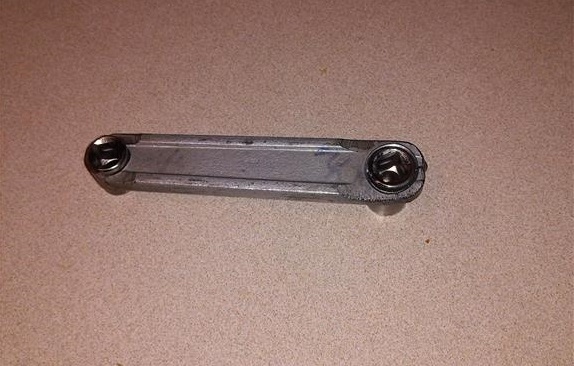

  • speedzter
    speedzter
    This was made up in a hurry years ago. Use at 90 degrees to your torque wrench, and the torque setting will be correct.
    Just remember to make the socket drive square to the shaft if your torque wrench doesn't ratchet !
    5/16"  for the rocker housing and rocker cover, and rocker support plate from memory .
